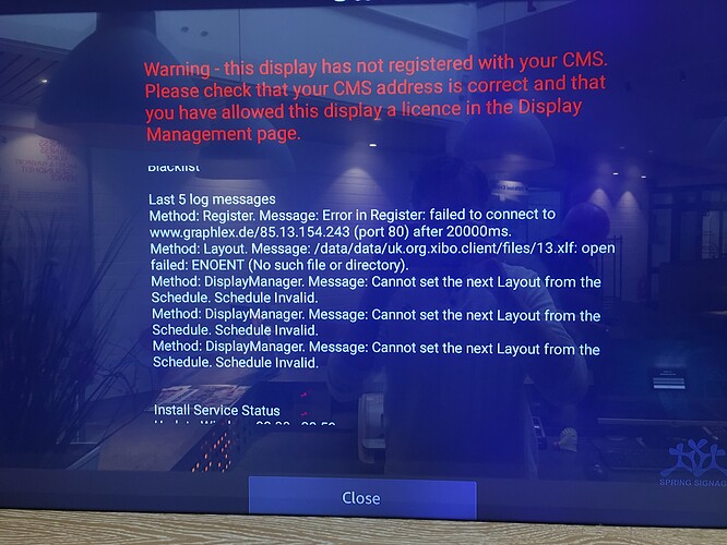

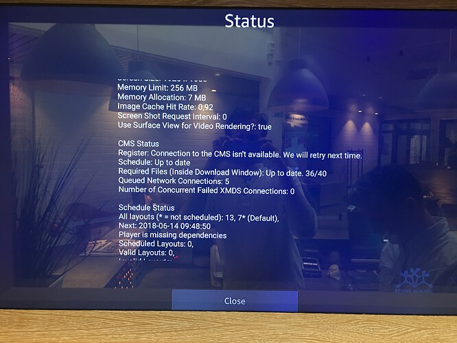

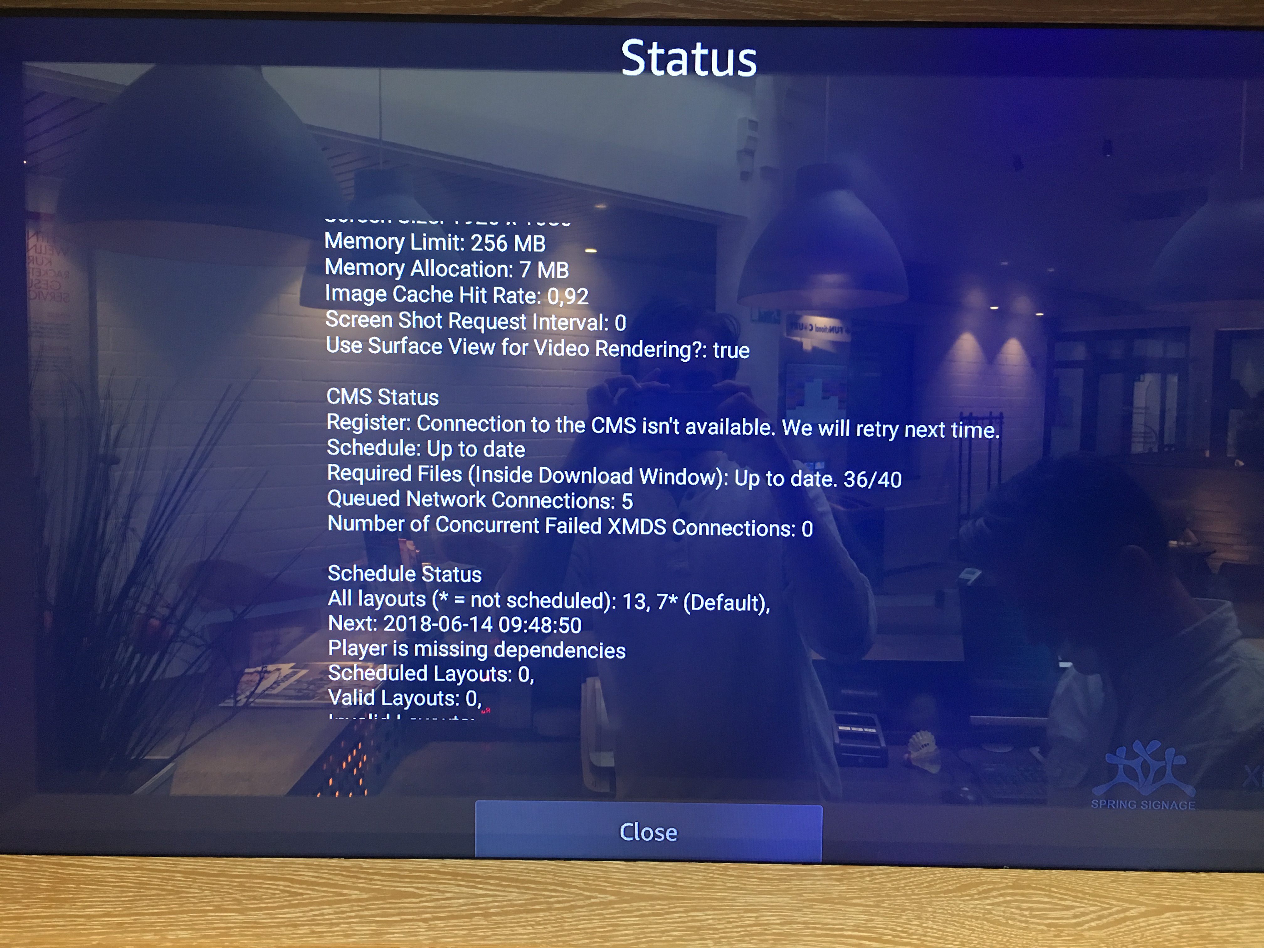

Please see attached the error status screens from the client:
As you can see, it’s struggling to connect - i have completely reinstalled Xibo on the client and did the full setup again, connecting it to the cms with a fresh license. For some reason, on the “Connect to CMS” screen, it sometimes displayed “Unable to connect to CMS” and sometimes just worked - the display is correctly registered in the CMS now (again) but still displays the errors on the log.
Is there something wrong with the network? Could it be some firewall problem? I’m stuck and i don’t know what to do from here (besides contacting their IT professional, asking if they made any changes whatsoever…)

It definitely looks like connection problem, it does not seem to be refused all the time (obviously), but something seems to be blocking / interrupting the connection between player and that CMS.
All other errors are most likely caused by the connection problem ie player can’t correctly download all content/schedule from CMS including module files it seems (missing dependencies).
It will retry the connection each collection interval, but if it can’t reach it or if it’s interrupted in the middle of the download then that can’t work reliably I’m afraid.
