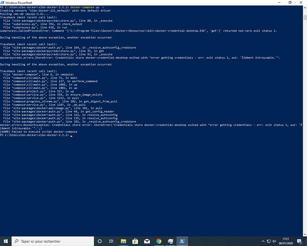

Alright I did what you said and another error showed up :
Is that the right directory?
Thanks for the screenshot. Your Powershell window suggests you’re not running it in Administrator mode. Can you try closing Powershell, then right click on it and choose Run as Administrator. Then cd to the directory and run the up -d command again. Once again if you encounter an error, please post a screenshot.
Upon further inspection, I found out I was not logged in on docker, which caused the previous error (same as previous post).

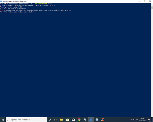

Here is what I get now :
Ok, alright, I found the problem : my containers were set to Windows containers.
Now, I have a problem similar to here : Xibo, docker, windows 10, failure - Fixed! Thank you Peter
