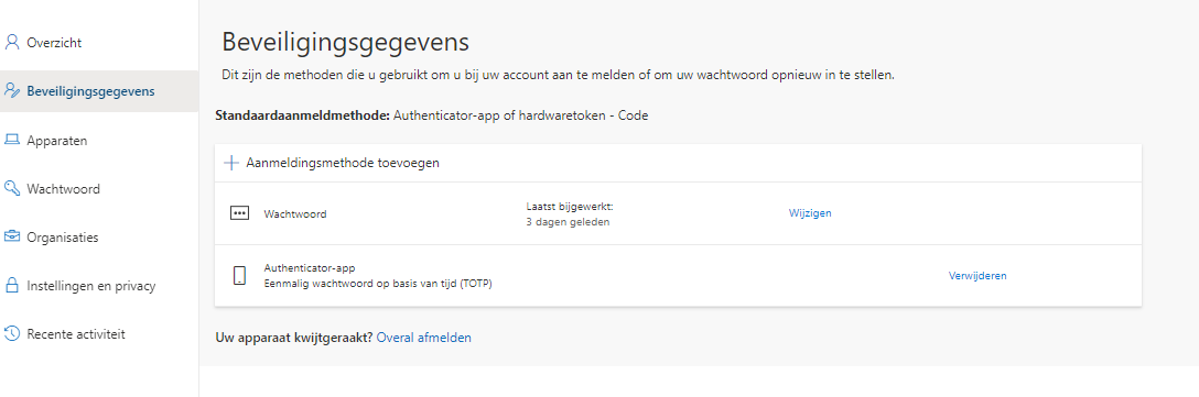

The user that is used has the TOPT configured. But we cannot remove the possibility for the password option. We have read somewhere that you have to remove all the other possibilities to logon but we cannot remove the password option.:

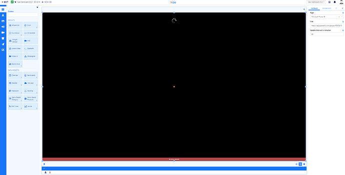

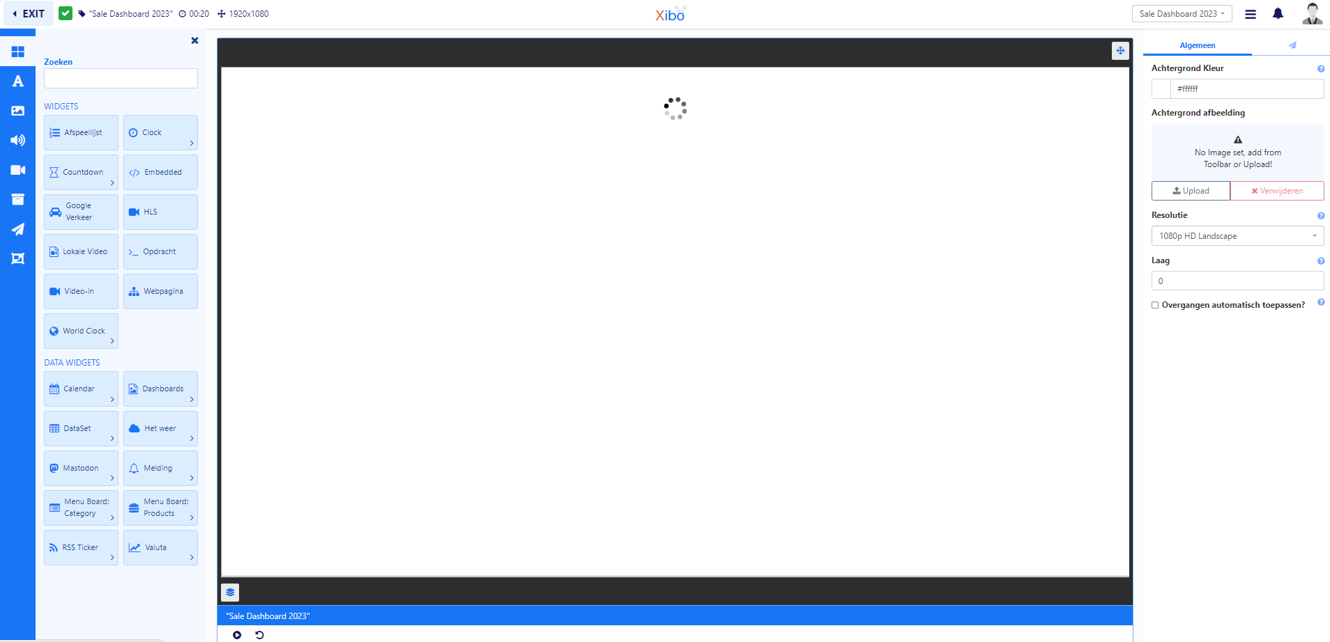

This helped indeed with getting rid of the message No token returned. But now there is only a turning circle in the preview screen and not the actual dashboard. Can we see somewhere what is going wrong with loading the actual dashboard.
It can take 1-5 minutes to load the first image once you have configured your URL in the widget, but please do open a ticket so that support can take a look with you.
