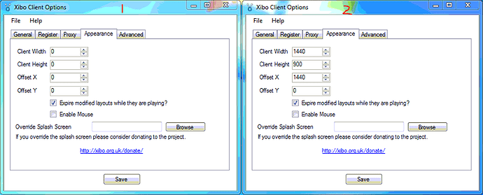

Hi Alex,
I managed to figure it out by trial and error. I have upload this photo so other user will be able to understand.
I have set my monitor to a resolution of 1440 x 900 so please refer to the setting below.
Cheers!!!
Thanks for the screenshots. Those are exactly the settings I meant. So you’re defining the player size and position with an offset of 1 screen size on Player 2. I’ll close the case.
