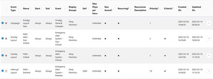

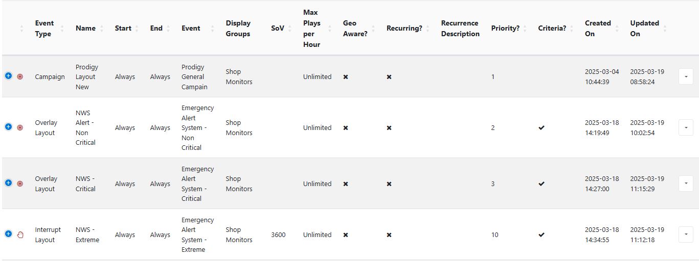

I thought I had this worked out, but I am still having issues (hard to test without actual alerts). Yesterday afternoon we had a tornado watch that turned into a severe thunderstorm warning (with watch still activiated). The tornado watch appeared fine under the schedule “non-critical” but when the severe thunderstorm warning was activated, the non-critical schedule disappeared, and the “Severe” schedule never appeared. I believe I have this setup to prioritize severe events over non severe events. Could someone take a look at my schedules below to see if this is how Xibo emergency alerts are set up, or if the three overlays are fighting each other? Unfortunately, this feature is so new, I can’t find any documentation. Thanks!

Hi @jkissel, If you’re using Xibo’s Windows Player, unfortunately, it doesn’t support the Schedule Criteria feature.
Your emergency alert setup is correct, but due to this limitation, even if the CMS pushes a new criteria via XMR, the Windows players won’t be able to evaluate and trigger layouts based on the updated criteria. This means the layouts won’t switch dynamically as expected.
Currently, the players that support Schedule Criteria are Android, Tizen, and WebOS.

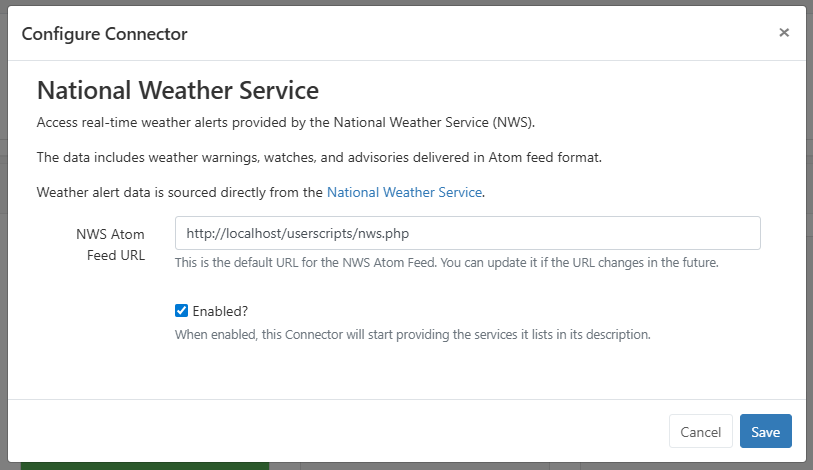

After confirming it works:
  • Go to Applications
  • Locate the National Weather Service Connector
  • Click Configure
  • Set the NWS Atom Feed URL to yourCmsUrl/userscripts/nws-test.xml
  • Save your changes
  • Now test the NWS widget in a layout and schedule it accordingly.
Note: Once you’re done testing, don’t forget to revert the NWS Atom Feed URL back to the original value:
https://api.weather.gov/alerts/active.atom

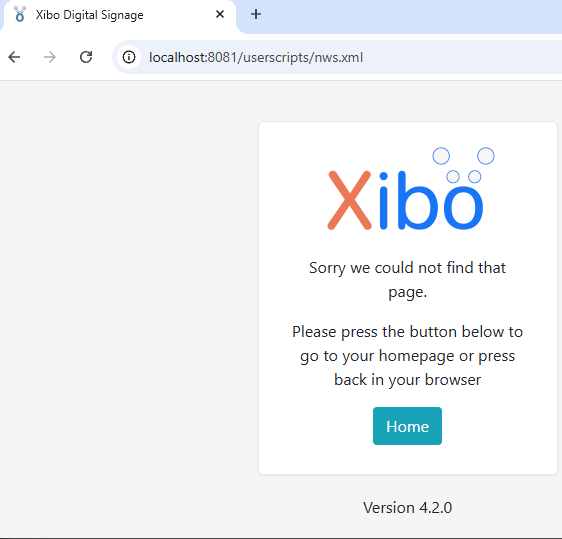

@Nadz I’m having trouble with “access it via yourCmsUrl/userscripts.nws.xml to test”. I’ve created a text file with the example you provided, then renamed .xml within the web/userscripts folder as shown in the picture below.
When I try to access it with “http://localhost:8081/userscripts/nws.xml” I get a return “sorry we could not find that page” (picture below). I’m not sure what I am missing. Is this folder specific? Am I typing in that url correctly?

Hi @Nadz, I’ll answer my own question. I ended up creating a repository from GitHub and pull a Raw link to the NWS connector. This is great, thank you!

I’m glad you could work it out. Just a quick note, the files in the /web directory is not folder specific. the reason for the userscripts directory is to organize the custom files. You could place it in the root of the /web directory if you want and you should be able to load it with localhost:8081/nws.xml.

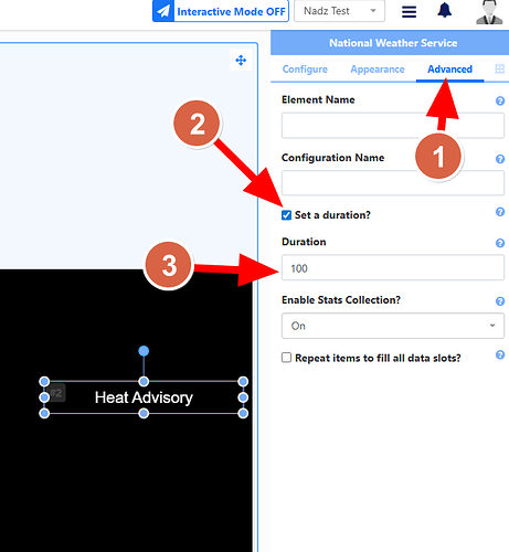

The delay between editing the file and seeing it on screen is due to the Widget Sync Task, which runs every 5 minutes. Among other things, this task retrieves alerts from the endpoint configured in the connector. If it finds an alert that matches your schedule criteria, the CMS sends it to the player, which then triggers the layout to play. So even if you change the file, you’ll need to wait for the next 5-minute cycle for the CMS to fetch the updated alert and push it to the player.
As for when it ends, the layout should automatically be removed from the screen after its duration is finished. The layout duration is based on the widget with the highest duration which you can configure in the Advance tab.
