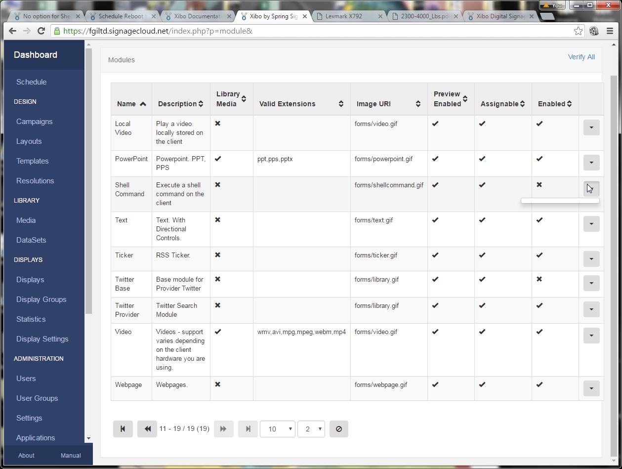

Yes it’s there and it’s listed with an X in the Enabled column, but there is no way to toggle this option. I can’t modify settings for any of these modules.
When I click the drop down menu I just get a small blank box with no options in it. Same for all lines, not just the Shell Command. Both Chrome and IE.

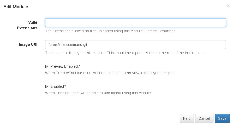

Try toggling the down arrow on the far right:
Clicking on Edit will then give you a pop-up that will allow you to enable the module:
Hope that helps!
If “Edit” doesn’t show up in the Drop down menu, that seems like an error of some kind. It works for me on Chrome just fine.

Just tried on a couple different computers and all I get is this:
btw It’s the same blank box under the drop down arrow for each feature under modules… with the exception of “Twitter Provider” where I do get the option “Connect to Twitter” in the drop down box for that particular line.
