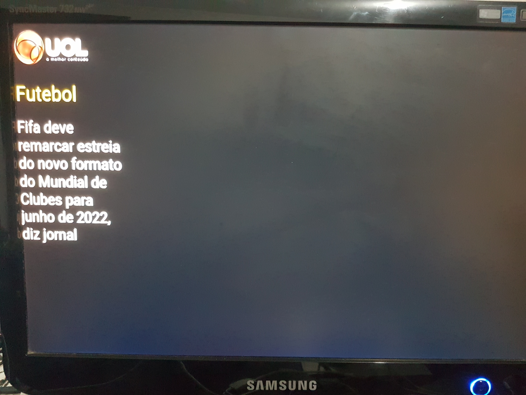

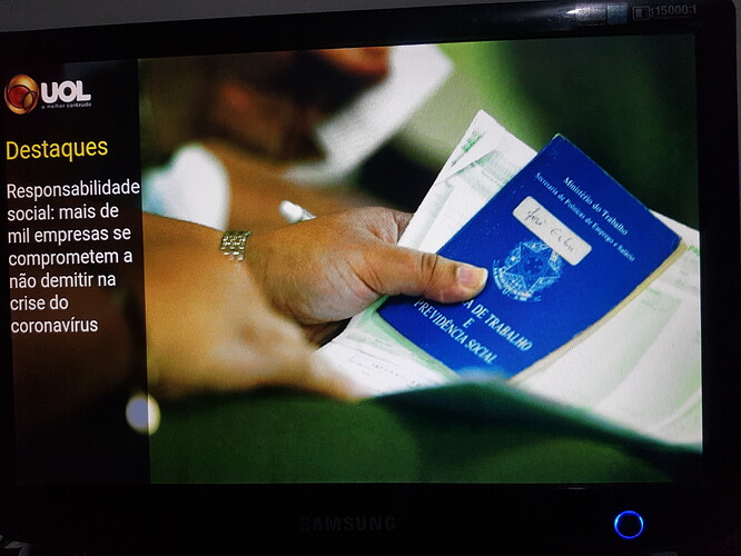

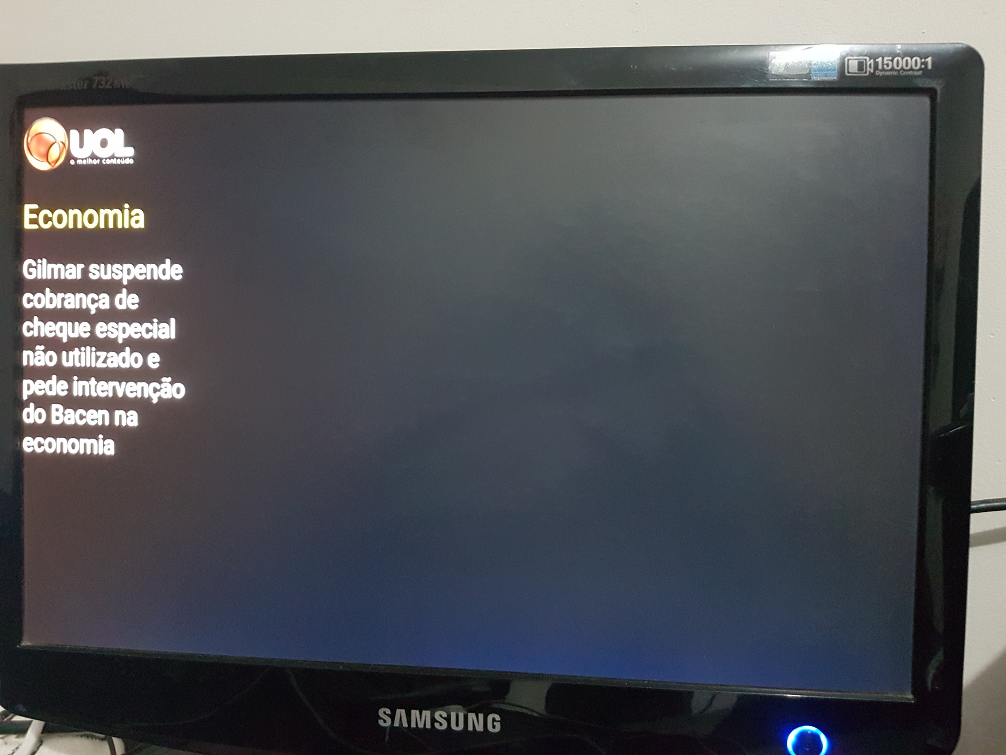

I have had a problem for some time and I cannot find the solution. I use an RSS Ticker Feed and for some reason, sometimes it displays the photo of the news and sometimes it does not, leaving only a black screen. I am currently using Docker and version 1.8.3 of Xibo. Has anyone experienced this problem?

The feed you link isn’t a proper MediaRSS feed so Xibo won’t be able to show the images from it without some customisation to the template.
I tried the feed in Xibo 1.8.13 and 2.3.3 and neither will parse it. It’s because the feed has errors in it. Those would need to be corrected to make it valid XML. I suspect your 1.8.3 instance was showing cached content from a time when the feed was valid.
Once it’s corrected, you can then extract the photo and description using [linkfoto|image] and [Description] tags.

What is very strange to me is that in Layout> Design> Preview Layout everything happens correctly. In the player, some images are displayed and others are not, randomly.
Images are downloaded to the Player as needed, so if you have a poor connection to the CMS (or its the first time you’ve shown the layout) then you would expect that.
They should be there the second time the layout shows.
It’s worth saying though that as the feed is invalid, the CMS can’t process it assuming it’s in the same state as it was earlier so if it doens’t have images etc then it can’t download them until that is fixed.
