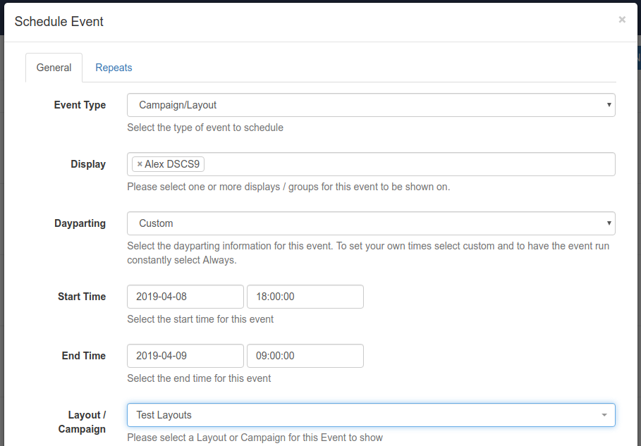

i need help again in scheduling,
so on all of my displays default layout is playing and i want to schedule a layout
from time 6pm tp 9am , i want this layout to be played at this time slot and again from 9am my default layout will start to play … i want this scenario to be played for 3 months everyday .

So you would schedule as follows
From: 2019-04-08 18:00:00
To: 2019-04-09 09:00:00
Pick you layout and the displays or display groups you want to schedule to.

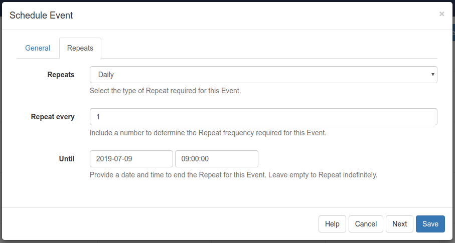

Then on the repeats tab, you set Repeats Every 1 day until 2019-07-09 09:00:00
That will cause a repeat every day for 3 months
When nothing is scheduled, your default layout will play automatically anyway.
If you have layouts with very long durations on them, that will interfere with when new layouts start and stop running as they will need to run to completion before that happens, so avoid very long duration.
