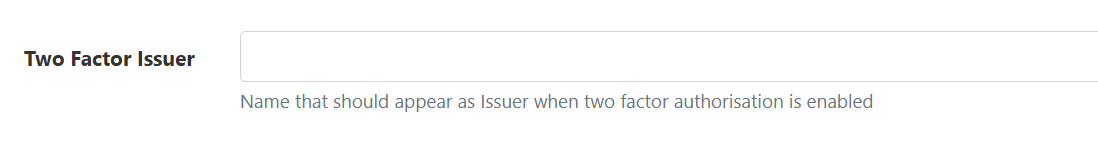

You probably want to set your Two Factor Issuer under the Users tab in Settings:
Pick something different for one of the CMS instances and you should get two entries in your TOTP app.
Thanks Dan!!
that did the trick!
