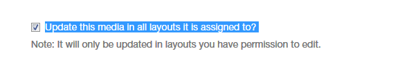

Are you checked this option?

Hi Jonatan,
Yes the option ‘Update this media in all layouts it is assigned to?’ is checked. The user has view and edit permissions on the media and layout.

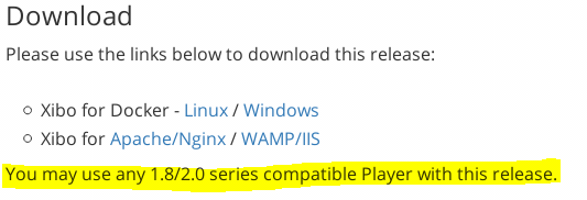

Thanks for your reply. just a quick question before I upgrade to 1.8.13
Will the 1.8.2 clients work with the 1.8.13 CMS, is this correct?

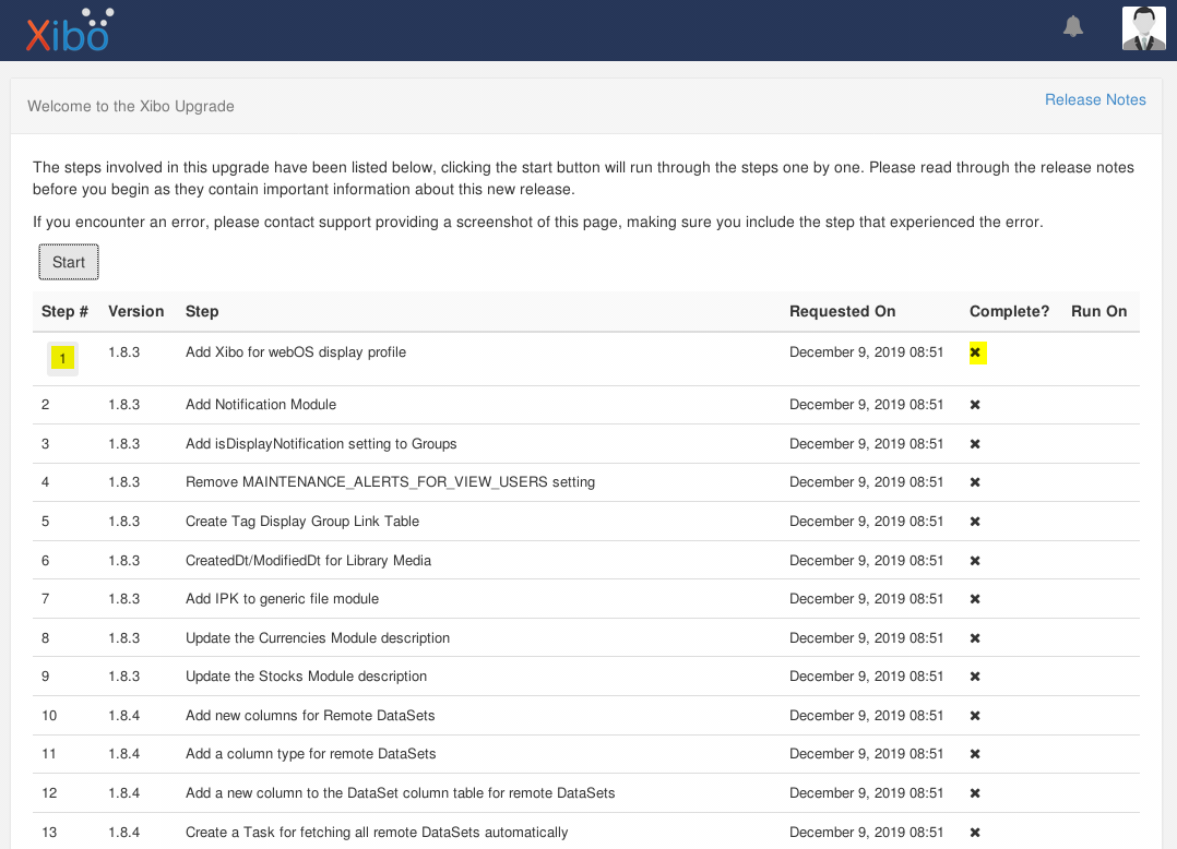

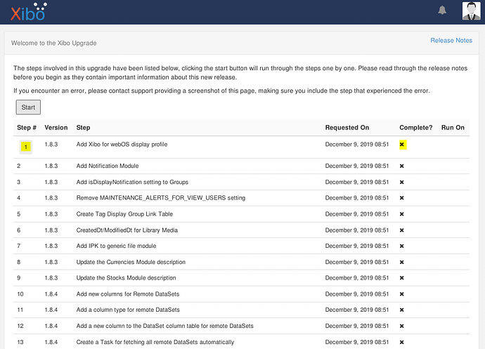

So I have upgraded the CMS but seem to be stuck on the Upgrade page with the steps not running at all:
Is there a log somewhere that I can look at to resolve the upgrade issues?
