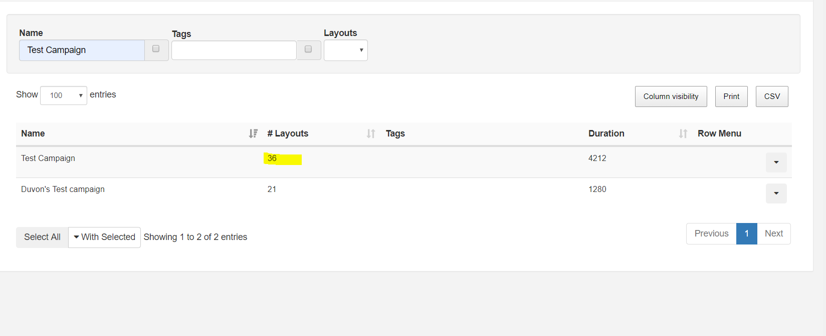

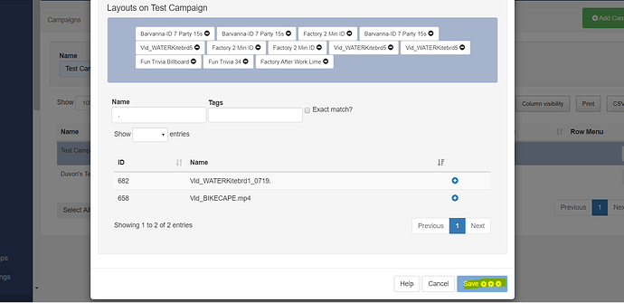

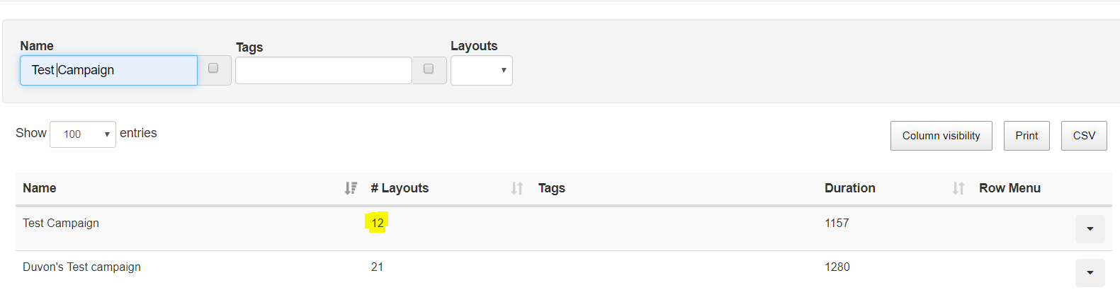

OK so I’ve been doing some investigating and here’s what I’ve found, there’s definitely a bug when creating campaigns. If you accidentally double click on the save button (twice, or three times) when saving a campaign. it seems to copy the entire campaign into itself. I’m not sure if this is related to the missing/shifting layouts. I’ve taken some screenshots to explain what I mean.

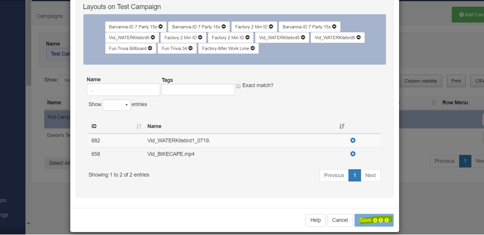

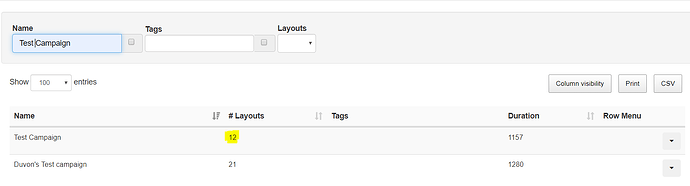

See test campaign below it has 12 layouts
Here’s the edit view of the campaign. As you can see in the bottom right i’ve clicked on save 3 times. (3 gears)

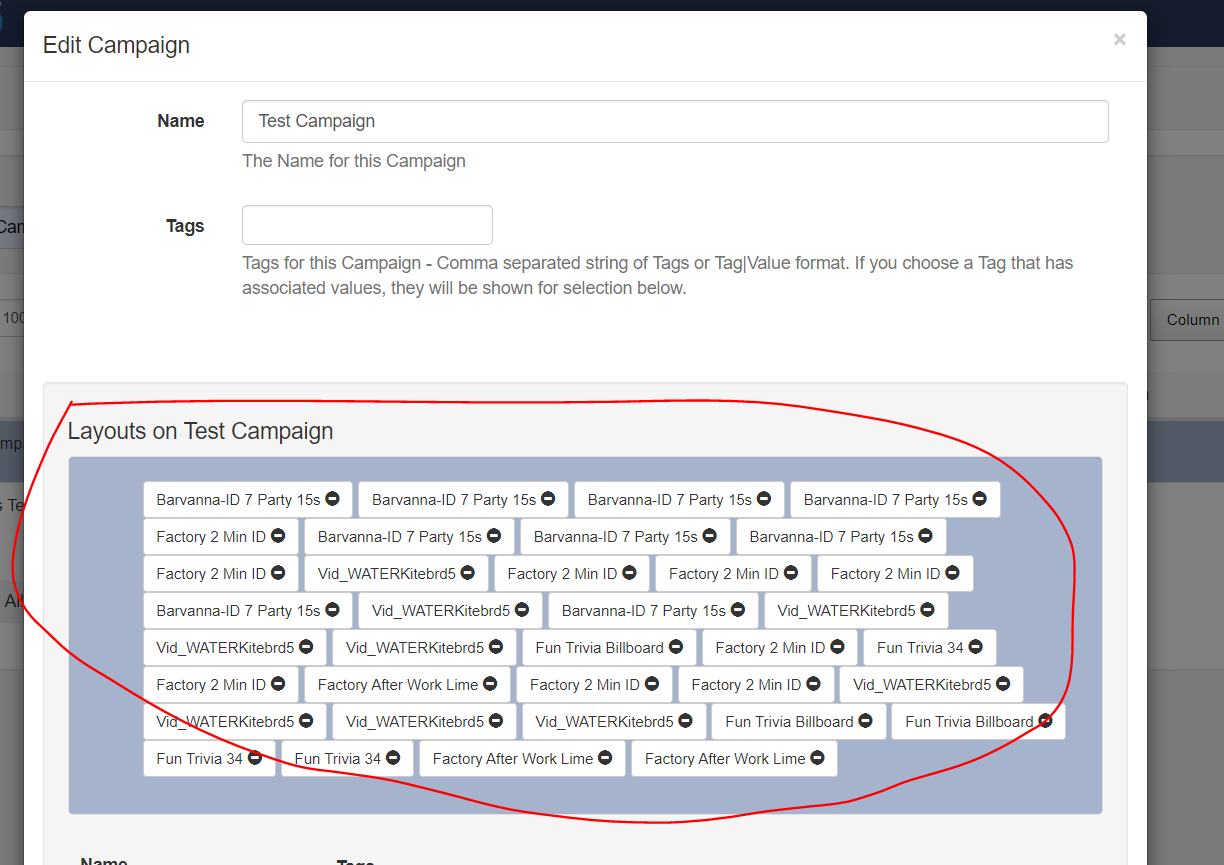

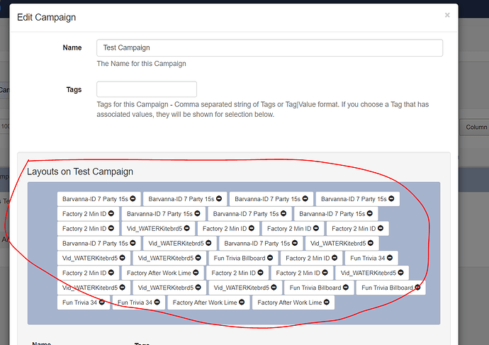

The campaign has copied the layouts within itself 3 times now.
This is what the edit view looks like
