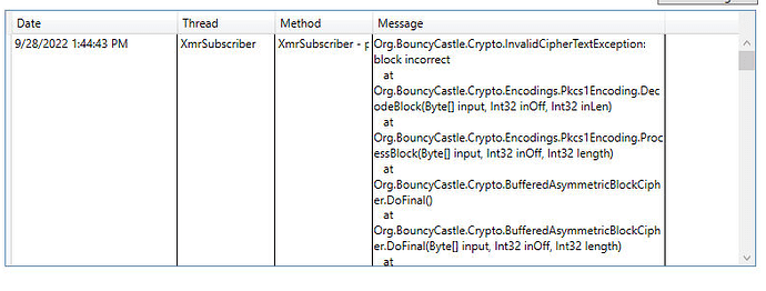

I did a test and change the schedule a few times and it had updated within 6 seconds and that is great, but I did a reboot of the player (Using send commands) and then it just stopped talking completely and I am getting an error “InvalidCipherTextException” (image below)
That error appears to be new to CMS 3.2 however the issue of the player just not updating seems to be the same as before, I hadnt noticed the error before so assume its only new to CMS 3.2.0

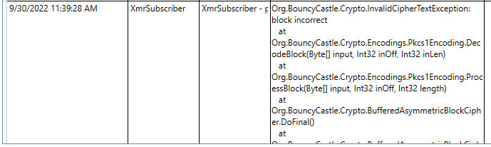

I have installed the older player version (v3-R303.0) and get a different error message but appears to essentially produce the same outcome where the player just will not update the content EDIT: Realised the error that I captured was actually the same as the one before, but I had seen one that was from the same module but had a different error
