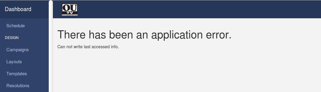

I have Xibo 1.7.5 running on Ubuntu x64 14.04 LTS with XAMPP 5.6.14-4. I had an issue where mysql was crashing (long story, but I was able to fix it), but in the process of troubleshooting, I reinstalled XAMPP, and restored mysql from a backup. I can now get the main Xibo login screen & it accepts my user credentials, however after logging in, I receive the following message:
There has been an application error.
Can not write last accessed info.
If I attempt to click on anything in the left column, it takes me to the login page.
Any insight would be greatly appreciated.
