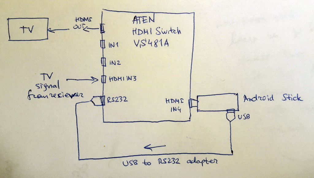

Requires the following diagram to see the picture…
What drivers for Android, what software, provided that the switch commands are available?!

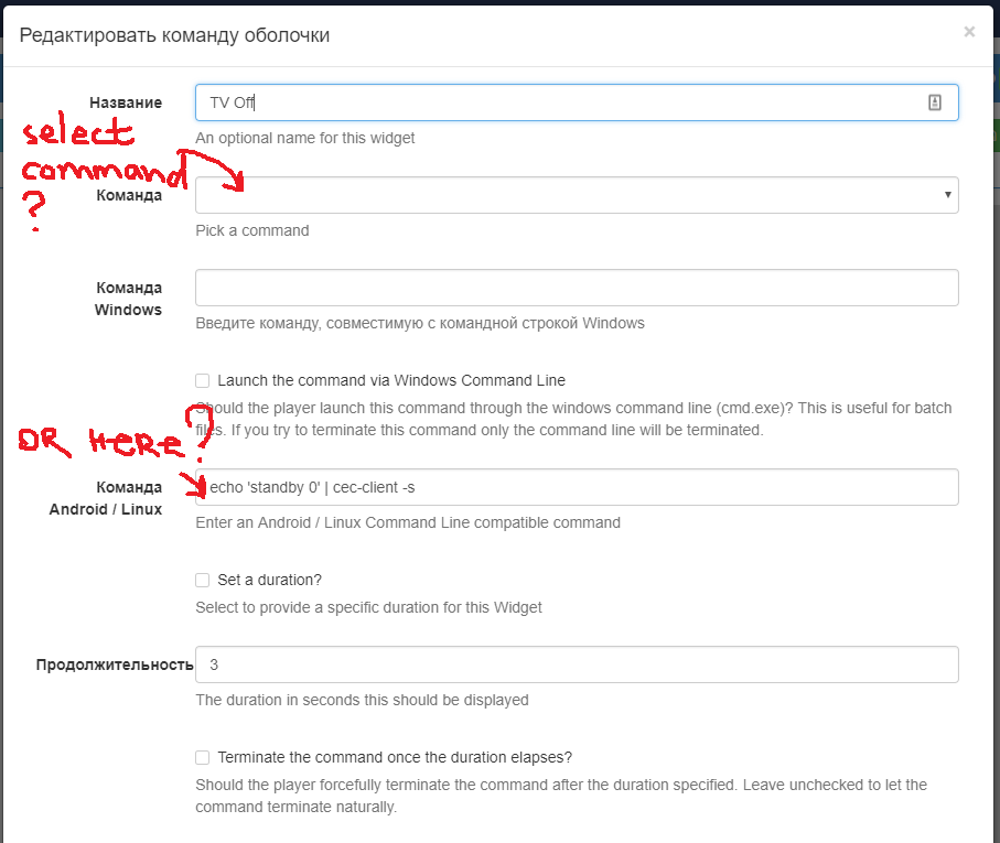

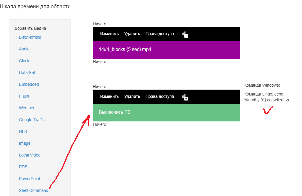

For example, I create layout and put here Video and Shell command.
That means, after video must work Shell command. Is’t it?
Now about Shell command format:
In Shell command window I must select previously set Command.
Is this Batch file???
What is his common format? “echo…”?
For example: On TV, Off TV, Switch Channel, etc

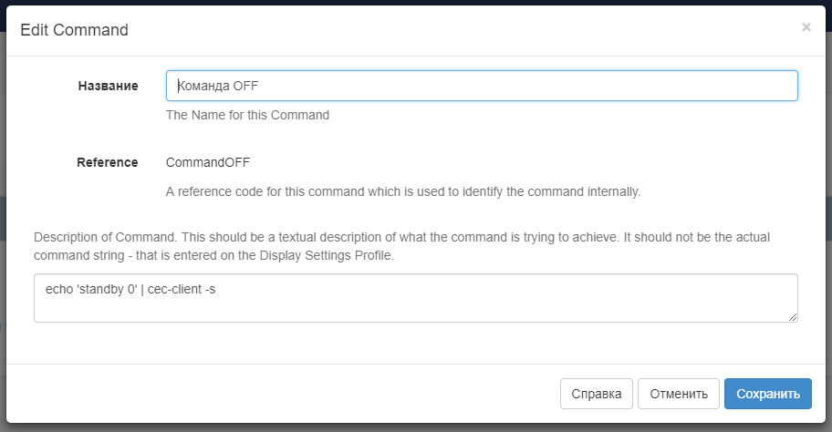

Now I suggest discuss HDMI-CEC. In documentation says that it is possible via batch-files: “Xibo doesn’t provide a direct interface to HDMI-CEC as there are many different manufacturer specifications, however it is possible to control HDMI-CEC via a batch file.”
Please discribe any examples about such batch-files, where they put etc…
