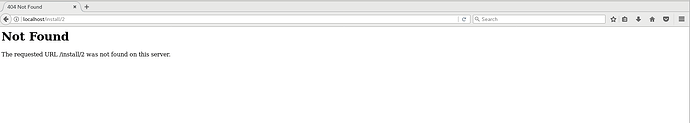

First, I would like to thanks Almond Wong for sharing this Installation procedure, I believed there is a problem with the installation script:
Using firefox I visited: http://localhost which redirected me to http://localhost/install … so far so good…
I understand that this first page is to check if my server meets Xibo’s requirements. All checked fine.
After I click on the “next” button is when I encountered an error.
The server shows the following.
Not Found
The requested URL /install/2 was not found on this server.
I check the directory ’ /var/www/xibo18/install ’ and I noticed that the directory ’ 2 ’ is missing. Any idea how to proceed with the installation?
