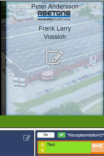

After upgrade from 1.8x to 2x on our docker install layouts no longer display images on our android display (i tried updating the client to 2x also but no difference …) i tried to upload images again and making a new layout to test with but when i use a text field and add an image from the library it shows in the preview just fine but when it display on the device the image is gone and if there was text below the image the text is bumped up to where the image was supposed to be.
Any idea what is causing this?

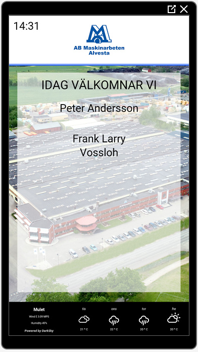

I figured maybe it’s a problem with the upgrade from 1.8x to 2.x that is causing my issue so i made a fresh install of a 2.0.3 Xibo with Docker but the same problem here … as u can see in the preview window the image is there but in the player it’s not there (both Android and Windows player)
Designer:
Preview:
Player:
Am i the only one that has this problem?

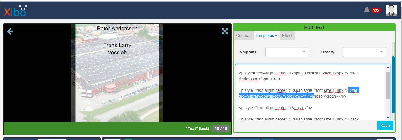

I have discovered a bug which could explain why you are experiencing this issue. The bug is caused by turning the Visual Editor on in your Text widget and then adding the image. This creates this line in your Widget:
<p><img src="/library/download/(Image_ID)?preview=1" />
If you turn the Visual Editor off and add an image to your Text Widget using the Library drop down menu, this line is instead created, which is correct:
<p><img src="[image_ID]"/>

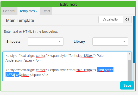

To correct this issue in your Layout, please try the following:
  • Open the Layout in Designer and edit the Text Widget.
  • Select the Templates > Main tab and turn off the Visual Editor if it is on. You should now see something like the screenshot below. Please highlight the same text as I have done in the screenshot.
  • Delete the text you highlighted but make sure to keep the cursor in the same place.
  • Now click the Library option above the template and choose the image you want to add to that Widget. The line should read something like this but the number in the brackets will be different for you:
  • Save to confirm the changes.
Once you have done that and Published the Layout, you should be able to see the image when you schedule the Layout to your Display. If not, please let me know and I will create a modified version of your Layout for you to try.

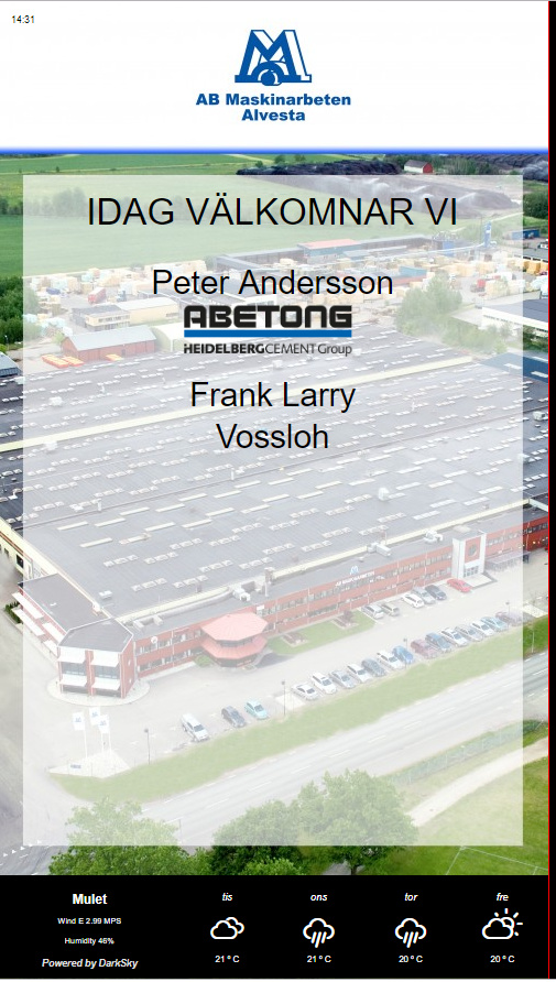

Many thanks DanBW that seems to fix the problem :slight_smile:
