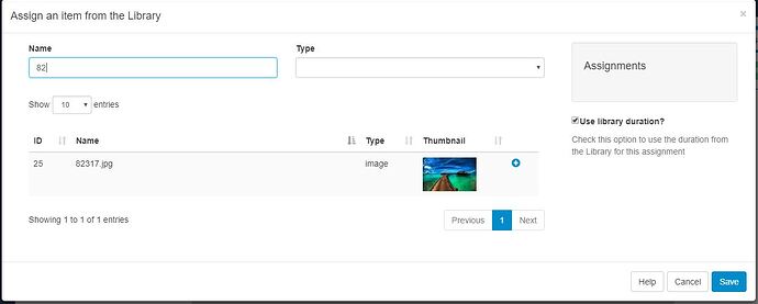

When you create an Image Widget for your Layout, you are asked to assign images to it by either uploading new content or you can view the Library and assign from there. Whilst you are in the Assign an Item From the Library Page, you will see a tick box named Use Library Duration? in the top right corner.
Can you confirm that this box was ticked when adding the media to the Layout?
I have included a screenshot below of the box I’m referring to.
