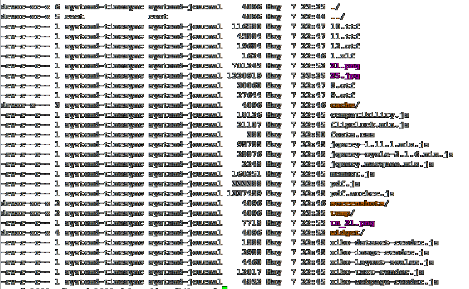

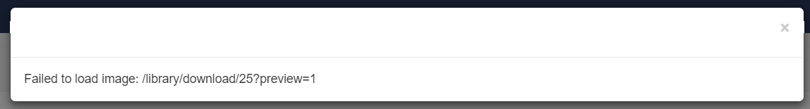

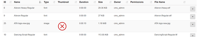

I have a jpg image that, when uploaded into the media library, causes sql/database errors which leads to severe VPS performance problems. From the Media window, the cms cannot create a thumbnail, nor can it preview the image. The image cannot be deleted either (a sql error occurs). The only way I can recover from this issue is to remove the image from the server via ssh. Once deleted, the cms is able to recover from the missing library image. Once the cms recovers, everything goes back to normal.
I have no idea what about this image is causing these problems. I have attached the image as well as various screen captures. Any help resolving this would be appreciated. Since I don’t know what is causing it, I don’t know how to guard against it. :frowning:

It doesn’t preview for me in the CMS either, I suspect because it’s using more than the configured PHP memory limit to try and load an image of that resolution in to memory to process it.

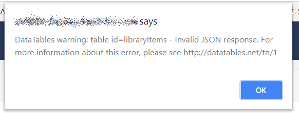

Why does it cause SQL errors? I may have been able to delete via the CMS if I could get past the SQL errors.
It doesn’t cause SQL errors. You’re getting an error that Xibo can’t connect to your SQL server. I assume because PHP uses more memory than your system has, and so MySQL is killed off. I can’t recreate that element of it here using the same containers, so I can only assume you’re fairly memory limited.
