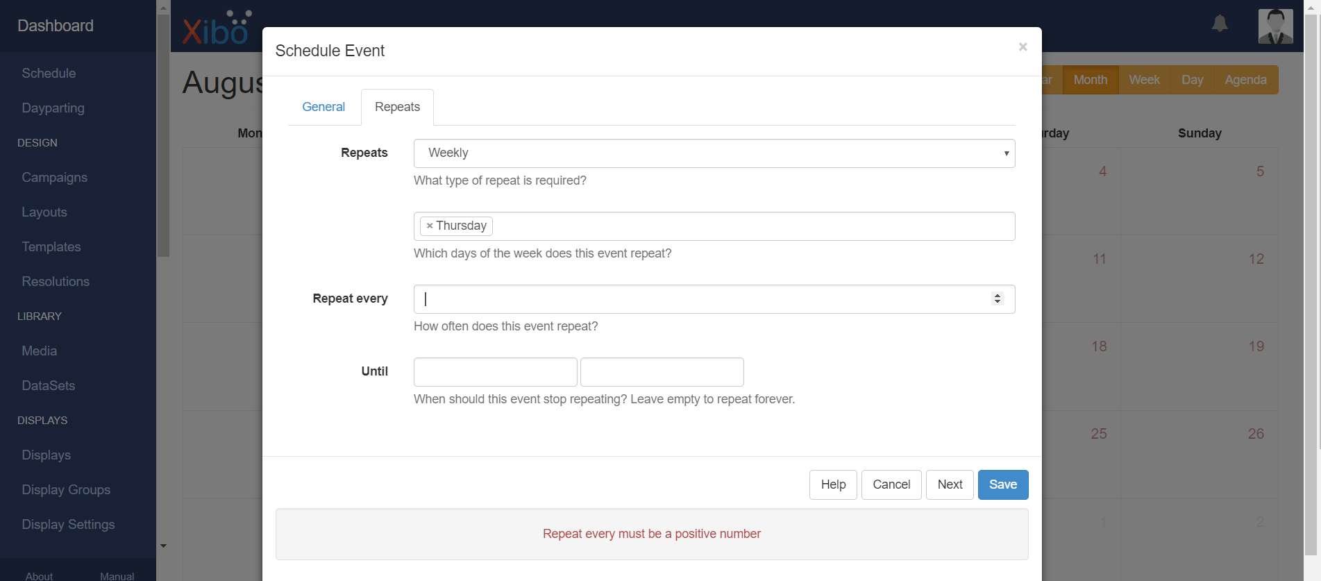

I followed your advice (I think). I created 7 campaigns (Sunday, Monday, Tuesday, etc.). The campaigns are made up of the normal rotation along with the daily agenda slide that I wanted included. Total run-time is 90 seconds. I set it to repeat weekly on Thursday. I left the “Until” section blank, so that it just keeps going indefinitely. BUT… I don’t understand what I am supposed to put in the “Repeat Every” box. It’s already been told to repeat every Thursday. The campaign itself is set to run all day (4:30am-11:45pm). So, what other information does xibo need to know? I’m just really confused about what to put in this blank.
You set the Repeats to one of the following per minute, hourly, daily, weekly, monthly, yearly.
Then in Repeat every you set the number to specify how often should that event be repeated.
ie every 1 hour, every 2 days etc.
In your case it should be set to Weekly and repeat every 1, as you want to repeat that event every week.
If you’d set 2 there then it would repeat every 2 weeks on Thursday.
