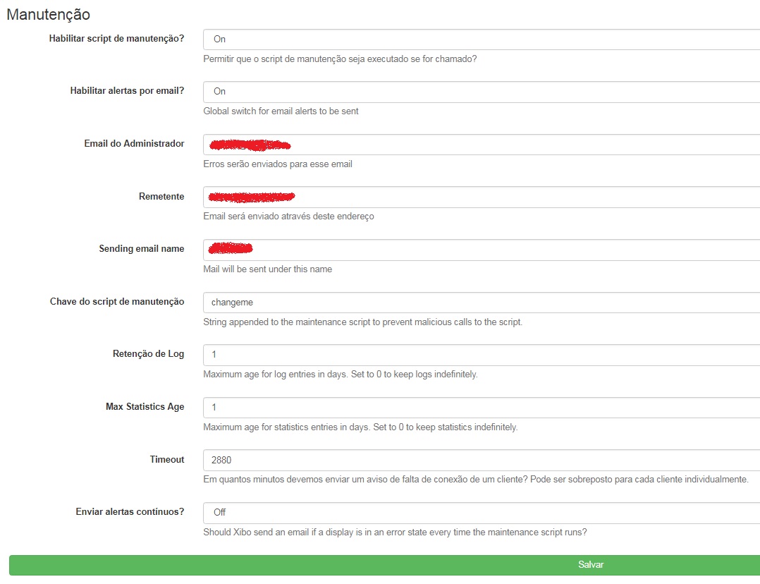

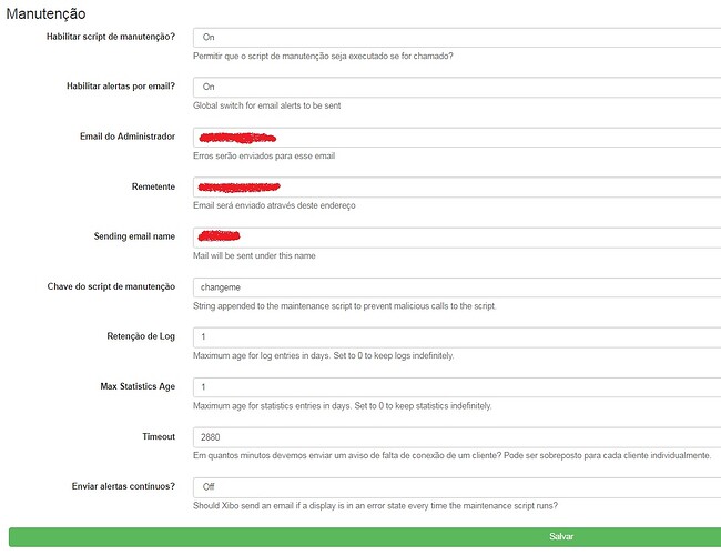

Could this have anything to do with how the settings below were made ?:
Log retention = 1
Max Statisctics Age = 1
Timeout = 2880
Send Alert Continuous = Off
Or the configuration of the “Email notifications” task ?:
Set: * / 10 * * * * *
