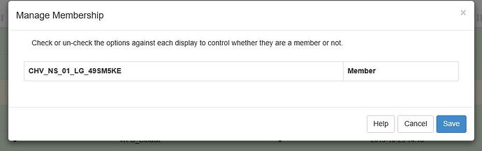

Unfortunately, I do not see the ‘Members’ option in the group row menu. I see the other options but ‘Members’ is not there. Could this be something to do with permissions?
Thanks for letting me know. It is likely that you are not seeing the option because of the permissions for your User Account. What User Type are you using? If you try this as a Super Admin User, can you now see the option?
There is an alternative way you could also try. This time, go to the Displays menu option, click the button at the end of the Display you want to add to a Group and choose the Display Groups option from the menu. You can see it in my screenshot below:
This option will also allow you to add a Display to a Group.

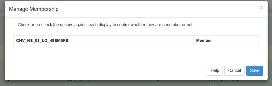

Hi thanks for your help.
Unfortunately, I am already a Super Admin and can’t see the option.
Also, I tried the alternative way and I don’t get any options to add displays to groups
Any further ideas?
Thank you
Thank you for confirming.Your screenshot is quite unusual, you don’t seem to have the check boxes you should have when adding a Display to a Group. Are you logged in as a Super Admin when you tool that screenshot of the Manage Membership page?
