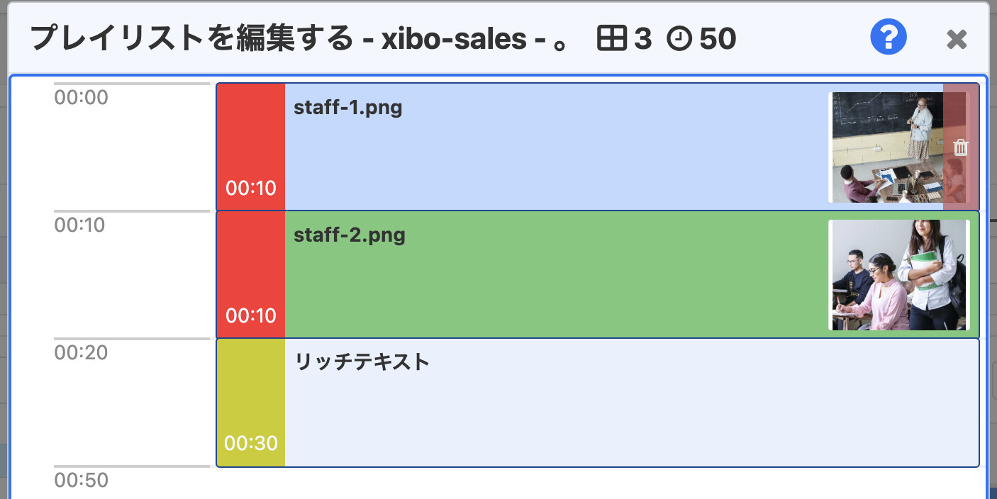

Screenshot 1 shows the state of the Playlist settings.

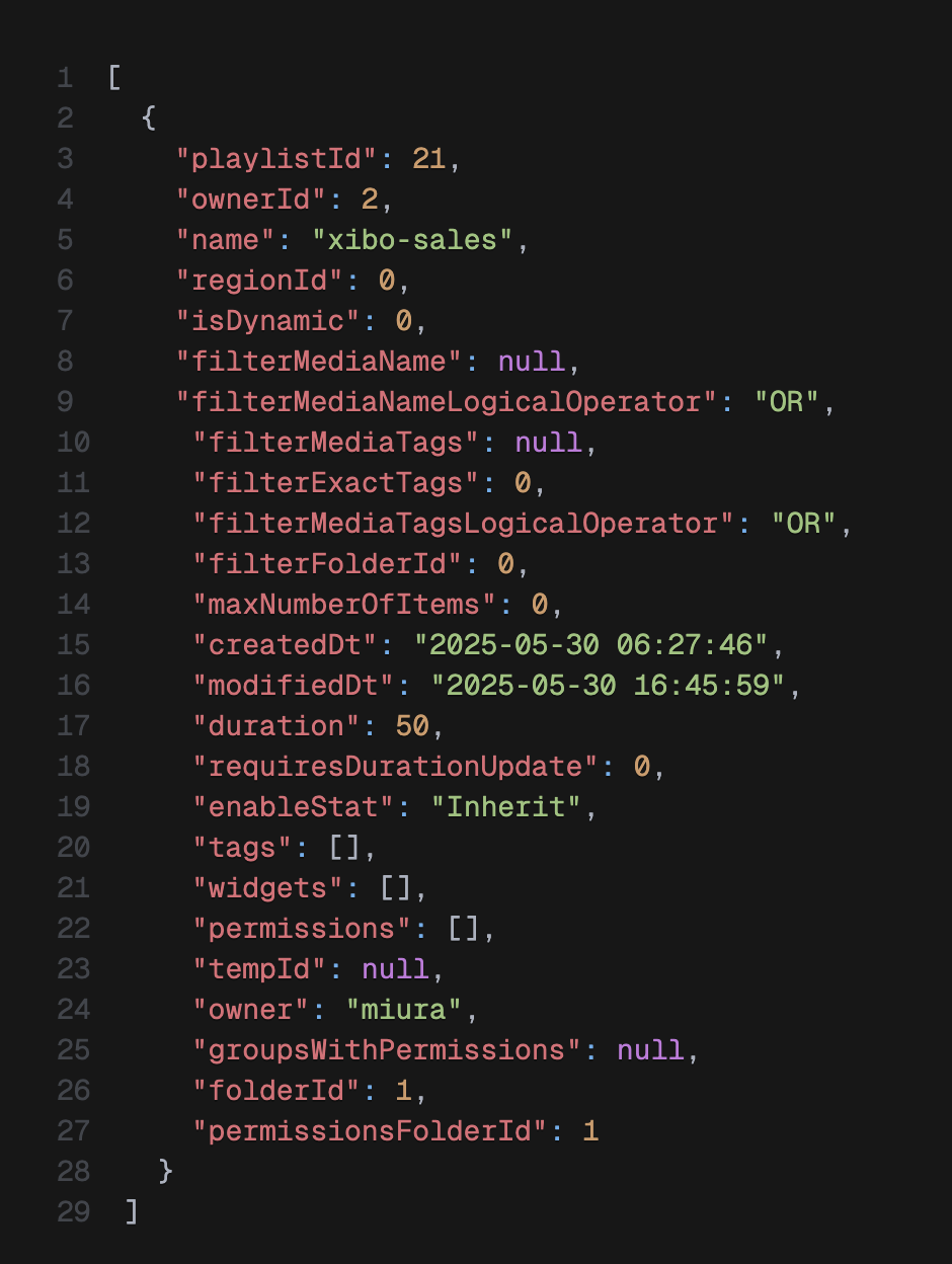

Screenshot 2 shows the result of calling /api/playlist in this state.
I expect to see the information of the wedget I am using, but it is “wedget:” and there is no information.
Can anyone help me how I can get the information for the wedget?

To list widgets in Playlist you will need to use the following endpoint:
GET /api/playlist?playlistId=XXXX&embed=widgets
Hello, israt.farzana-san,
Thank you so much for your advice.
By using embed parameter, it is now possible to retrieve the data properly.
