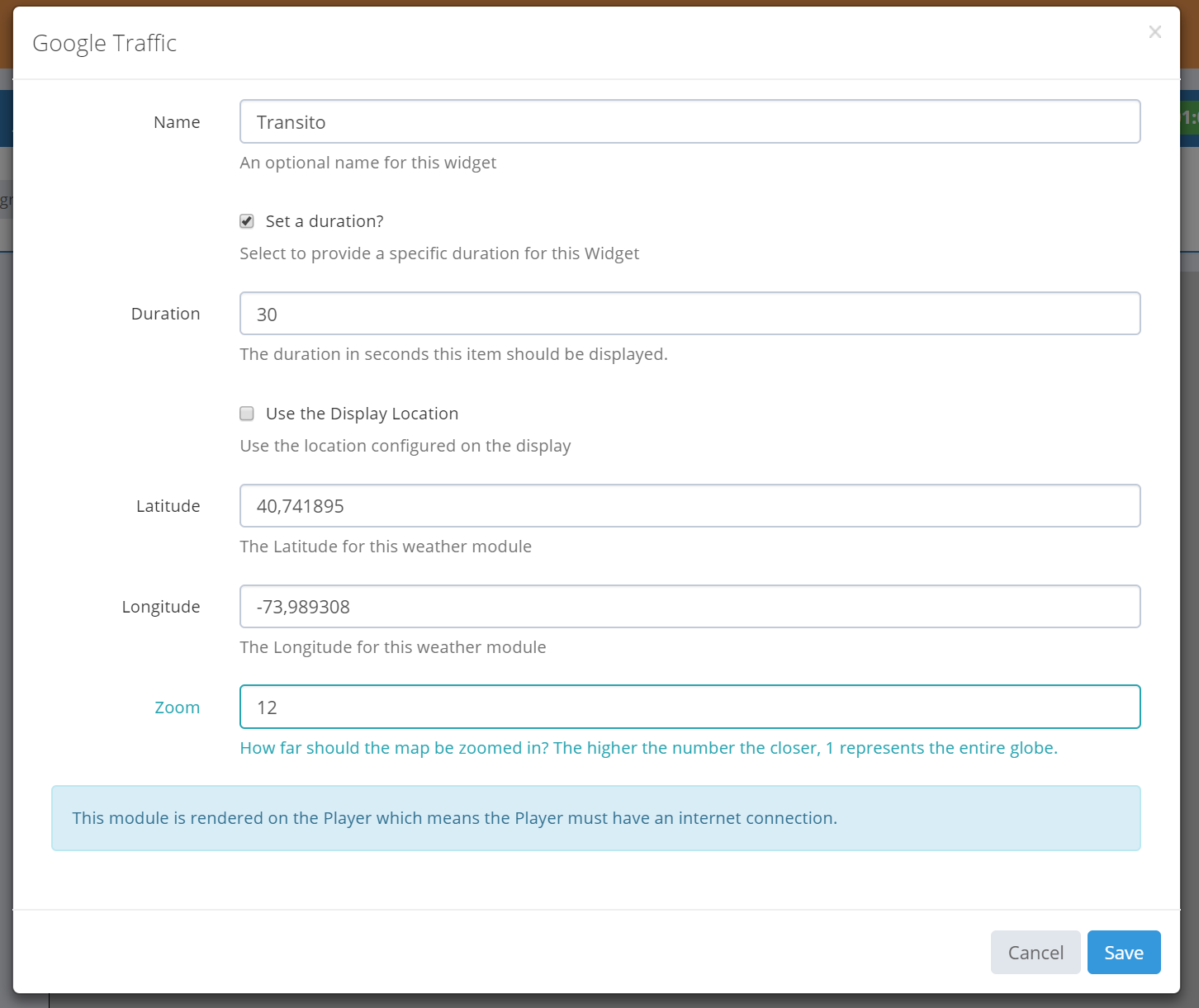

Today I tested the functionality of the Xibo Transit module.
Unfortunately there is an error in the positioning calculation according to Latitude and Longitude.
See the example below,
New York
When setting the coordinates in the module, see the result:

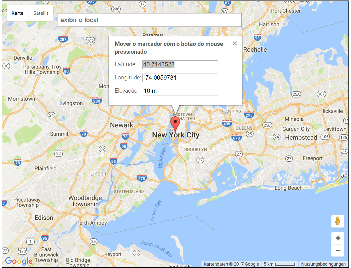

I wonder if there is interest in financial support to improve usability. I think reporting the address instead of the coordinates is more appropriate.
Both the Weather Forecast and Transit modules and Player Localization could benefit …
Usability Reference: https://www.gps-coordinates.net/

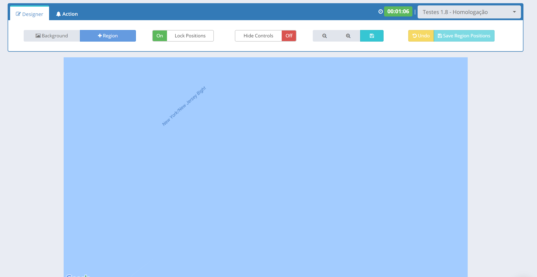

Hello … Good evening.

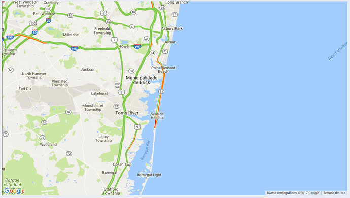

I did not analyze the result in the player, basically I tested it by the layout designer. Placing as coordinates in the Traffic widget, the result in the layout designer is wrong,
In the editor window the preview pulls from the CMS coordinates.
This information is not correct, the designer layout is using the parameters of the screen, it is only rendering with a significant displacement in LATITUDE.

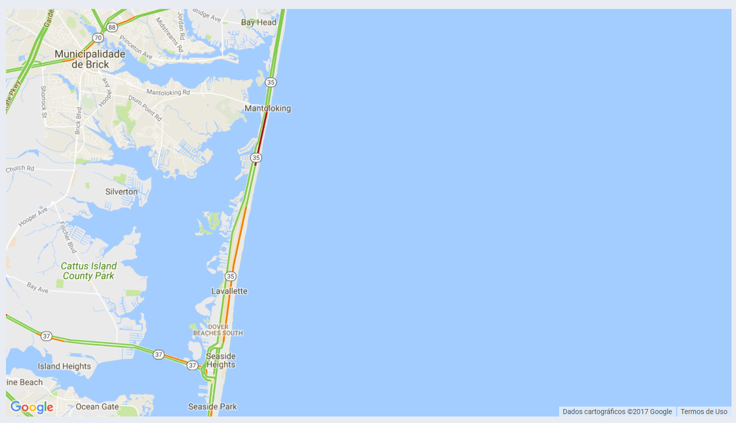

From the tests I did, I noticed a shift of about 3 degrees in Latitude

I do not think it’s a cache issue, because by switching to other coordinates the problem continues, a small significant deviation from the central position of the map.

Google Maps:
Layout Designer using same Lat and Long and Alt.

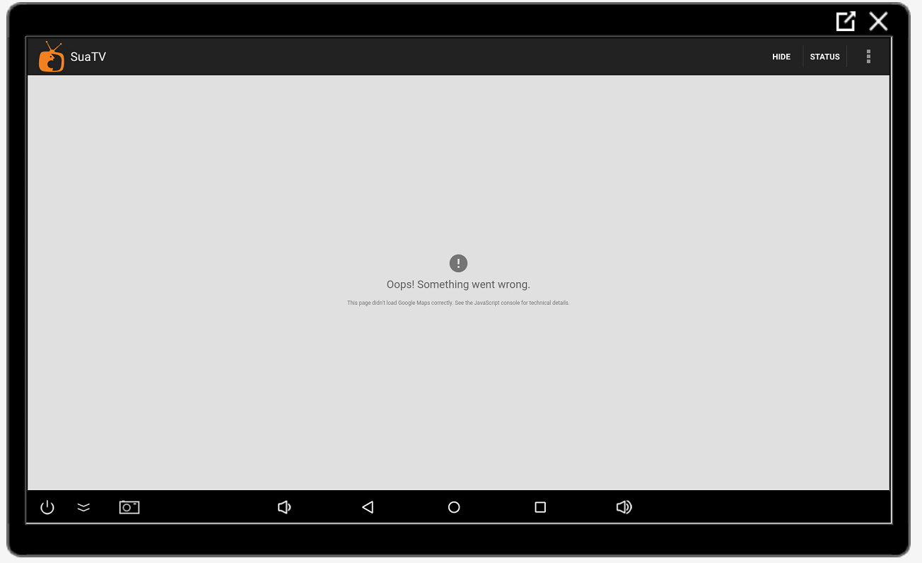

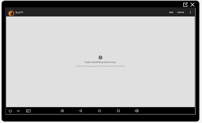

Player R102 Android (internet connection OK, access by Teamviewer)
Windows Player And Android Player have the same problem. They load the map according to the position in the layout designer and then display the error message.

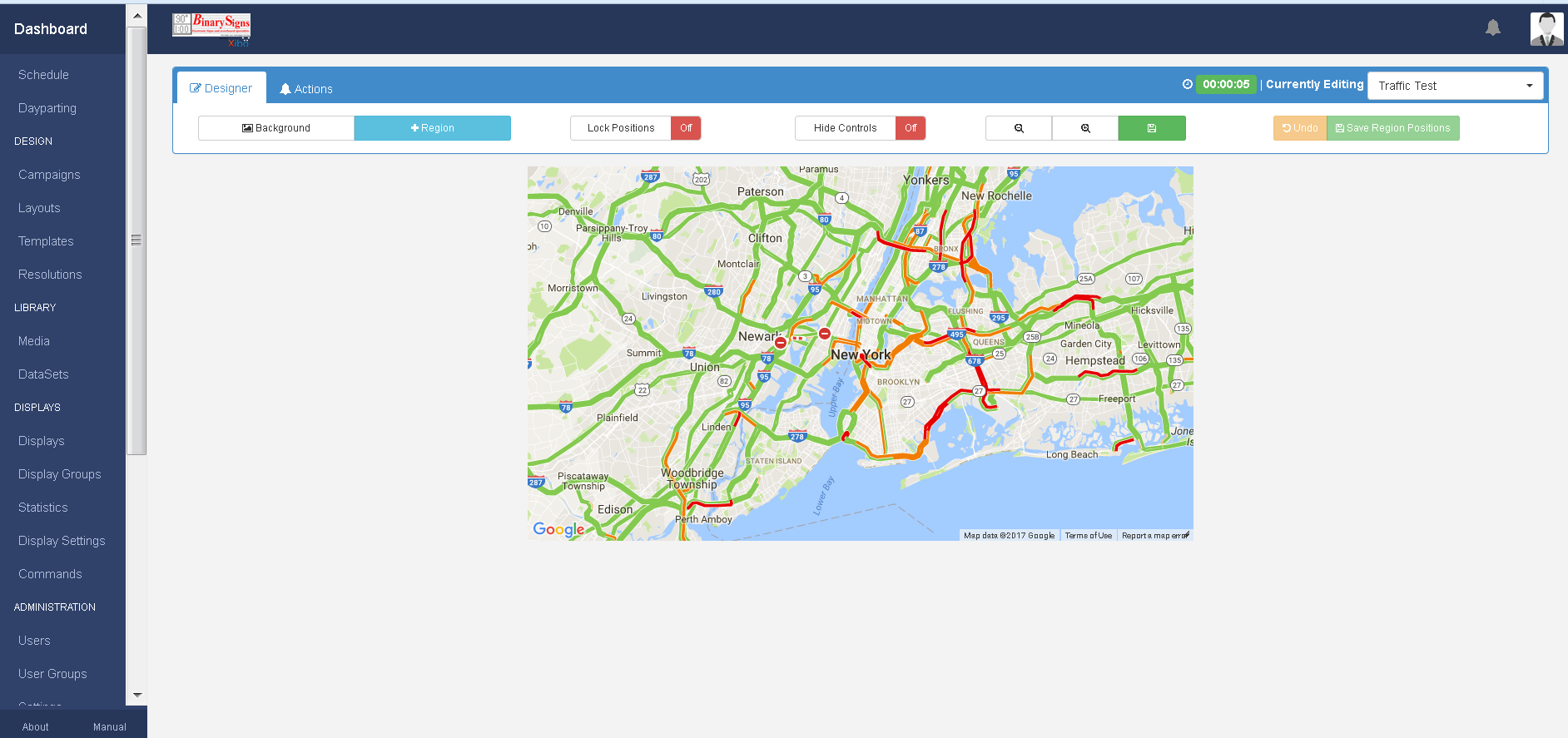

hmm, in my servers i get
Not sure whats going on there.

Without making any changes to YOUR layout, see that the image is different:
Unfortunately it should be something related to server configuration, language / server , php, something is wrong and I have no idea what can be …
regardless, it would probably play in player just fine as all the data in the layout seems fine to me. and it loaded fine on my client as well (windows)
