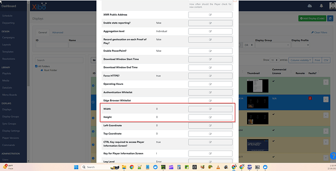

For the dataset issue, when the canvas size is set to 1080p and you are getting an error, please make sure that the display dimensions has nothing set on them by putting 0 for the height and width field. This will ensure that the 1080p layout will span accross the entire physical display. Please make sure that the widget sync is running under CMS > Task > widget Sync > click the row menu> Run on your local CMS and check if the issue still persists. I will check with the development team if there are other task needed to be sure running for Datasets to make sure it will work.
In your CMS, go to Displays page, click the row menu of the display, click Edit, and finally on the Settings tab, scroll down to find the height and width dimensions and set them to 0.
