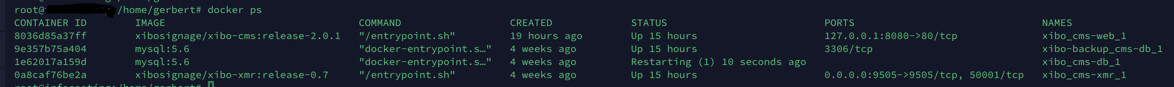

Used the command
docker ps
The SQL-server is restarting every minute
