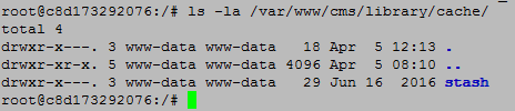

Yes, there is a folder in
shared/cms/library/cache
drwxr-x—. 3 33 33 18 5. Apr 14:13 cache
And inside is a stash folder:
drwxr-x—. 3 33 33 18 5. Apr 14:13 .
drwxr-xr-x. 5 33 33 4096 5. Apr 10:10 …
drwxr-x—. 3 33 33 29 16. Jun 2016 stash
I restarted docker-compose, but the Error is still there…

Can you check what the permissions are on that folder from inside the container.
It’ll be /var/www/cms/library/cache
alex
April 5, 2017, 1:12pm
8
That looks reasonable.

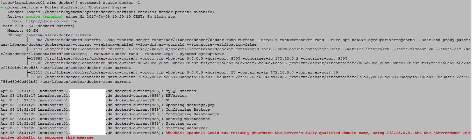

Here the Status of the Docker-Application Container Engine, maybe it helps:

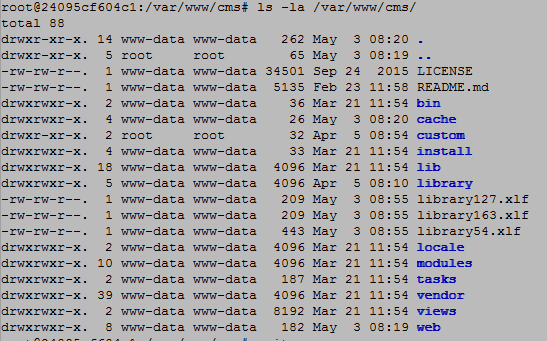

Check the permissions on the library and cache folders inside the container. They should be owned by www-data.www-data
recursively.
nless
May 3, 2017, 8:58am
13

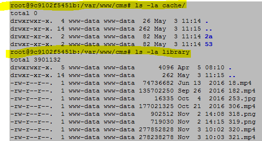

Inside the container looks all right:
alex
May 3, 2017, 9:01am
14
It’s the contents of the library and cache directories we’re interested in. That doesn’t show us what the permissions on those are.
If you ran chown -R www-data.www-data library cache
from that same directory (/var/www/cms
), that should sort them out if they are wrong.

I ran the new corrected SQL command but the error is still there.
Inside of /var/www/cms/cache and /var/www/cms/library:
alex
May 3, 2017, 11:43am
16

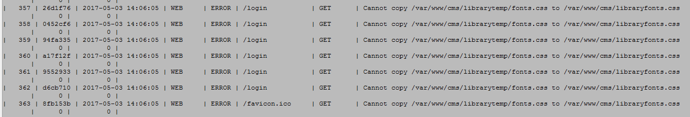

In the log Table i find this here:

This folder and file does not exist in the container:
alex
May 3, 2017, 1:34pm
19
Correct it doesn’t.
That should be /var/www/cms/library/temp, which should exist.
The missing trailing slash was what the last SQL update statement should have resolved.
Did you recreate the containers, as that should have flushed any caches that were holding the incorrect value.
Worth also deleting anything in shared/cms/library/cache
directory.
