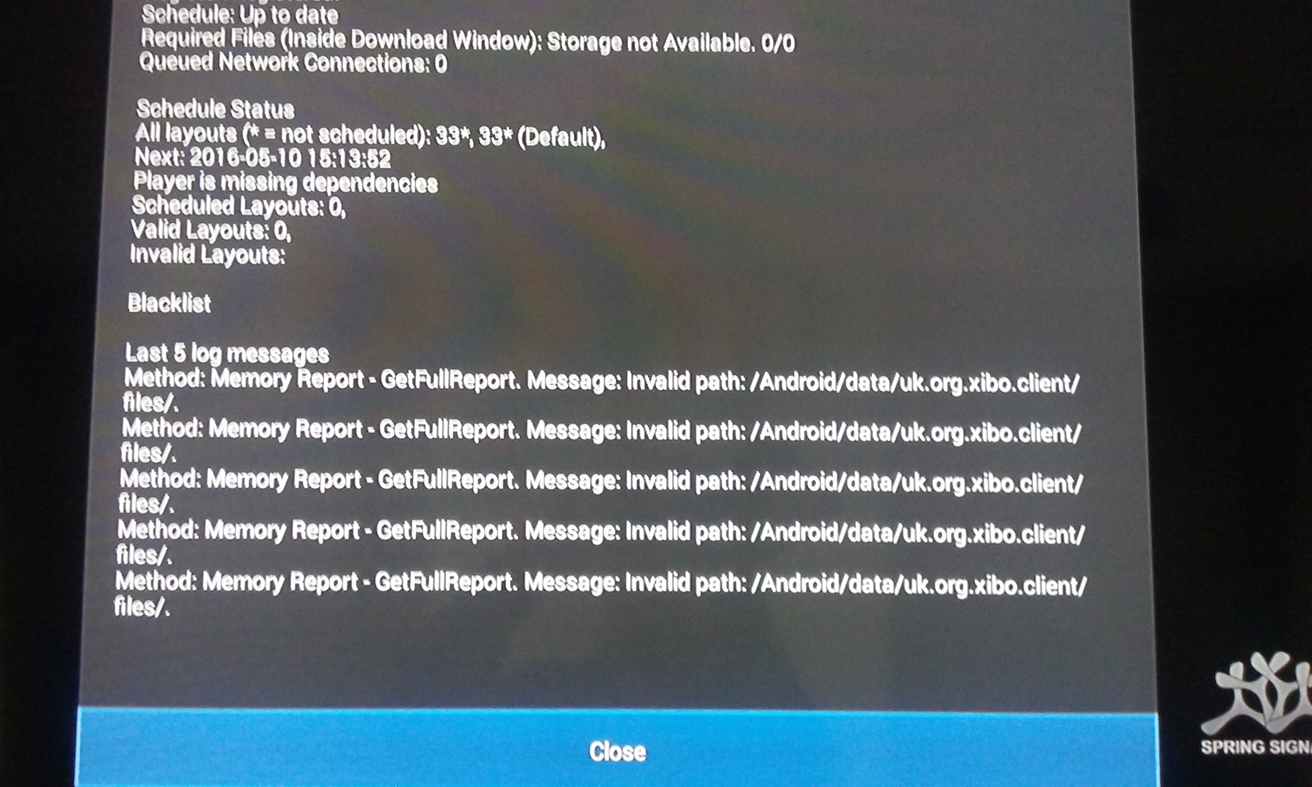

It looks like your currently selected storage become corrupted/unreadable (assuming it did work before) you can try to change it in Xibo settings on your device - are you using internal or public storage?
What has changed since it did work? What’s on the layout 33? Is your device logged in to the CMS?
Are you using R60 and 1.7.7 CMS?
You might want to also enable debugging (Report fault page in CMS) and see if there is anything in the logs that could explain this problem.
