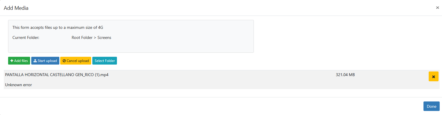

H again,
I tried to upload the video throught Firefox wrobser and I get this error
0x0

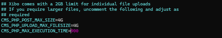

On top of head, what is your upload timeout ?
Check your “config.env” for this part of upload section:
Xibo comes with a 2GB limit for individual file uploads
If you require larger files, uncomment the following and adjust as required
CMS_PHP_POST_MAX_SIZE=4G
CMS_PHP_UPLOAD_MAX_FILESIZE=4G
CMS_PHP_MAX_EXECUTION_TIME=900

Thanks for your answer,
Previously was like this
**CMS_PHP_MAX_EXECUTION_TIME=600
I changed it to 900 but the issue persist.
This is my current configuration.
Thanks again

Hi 0x0
I found the error, It was AWF, Im using cloudfare I stopped it and I could upload the video
Thanks for your help
0x0
6
Glad you solved it. I was thinking on fpm.socket next …
