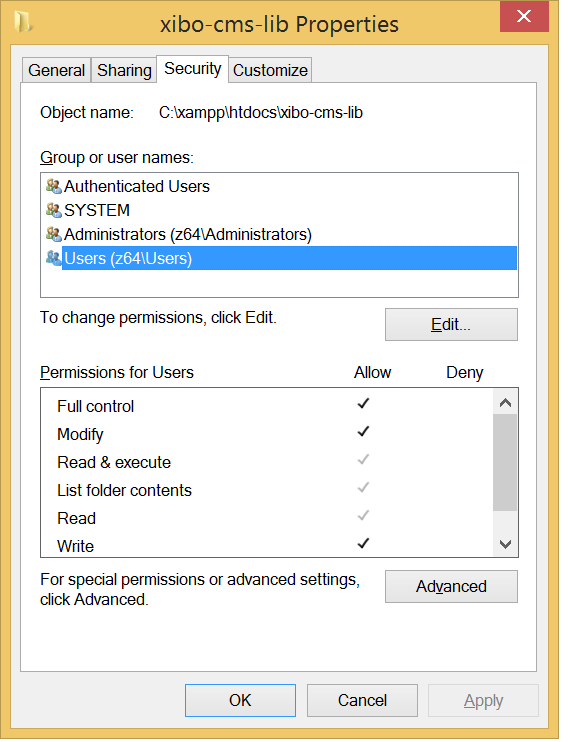

Ok have give “Full control” to “Users”.
Yes, i can’t explain why there is not enough Information in the log, i know there should be the chunk-messages.
Please - I said “Everyone” :imp: That will ensure there are no filesystem problems. “Users” is a group so there’s the possibility that whoever the web server is running as isn’t in that group.

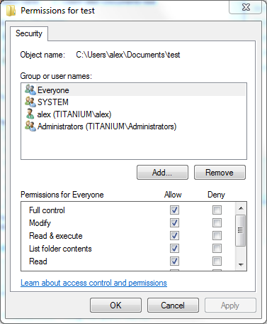

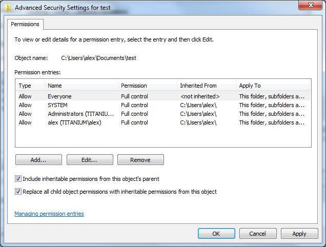

There’s a builtin group called Everyone. Add it and grant Full Control. I don’t see how I can be any more clear. Then ensure that all sub files and folders are set to inherit those permissions. You can enforce that from the Advanced dialogue.
Like this:

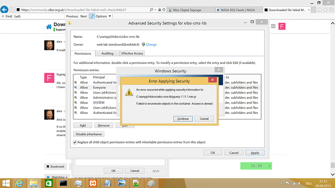

I have now added everyone, sorry.
And set the tick for “Replace all child object permissions with inheritable permissions from this object?”

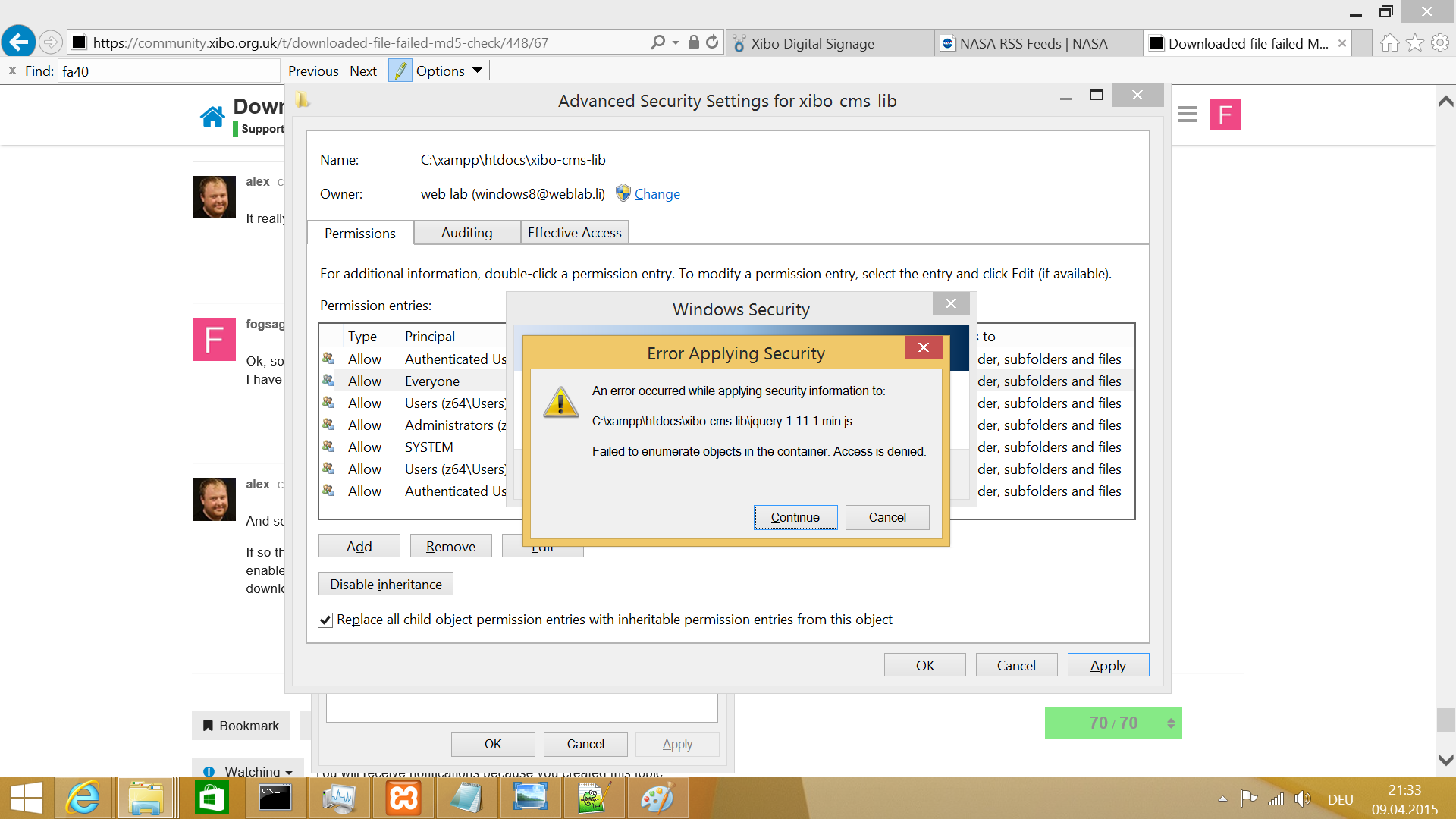

If so then please run up the report fault wizard as I described earlier, clear the library on the player you’ve enabled auditing on of the ticker_ files that are causing the problem, then run the Player and have it do the download.
ok, this message is diplayed and i had to click x-times for each file inside
I think I’d start with a chkdsk on your filesystem. That’s Windows telling you it can’t read the contents of the directory.
Ok, it is a new minix z64 with 32 gb mmc, hope not that it is defect…
I’d say there’s a good chance you’ve got filesystem corruption.
