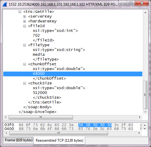

And here is a packet i captured with wireshark (old installation - thats why i installed everything new):
Is it ok that chunkOffset is 48000?

It’s an odd offset but not impossible. You’d see that if a download failed and the client tried to resume the download from that point.

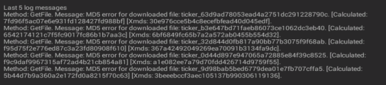

EDIT: And after deleting the “big”-image feed, no md5 error. On the first installation i got the error also for the “small”-image feed.
EDIT: Same with linux-cms and android-client:
