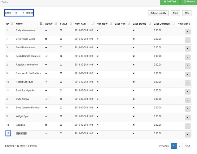

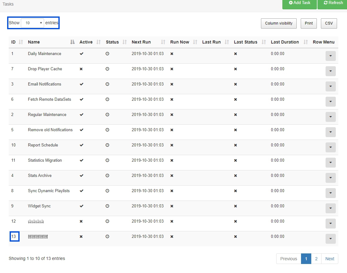

Thank you for your message and for bringing our attention to this issue. I can confirm that this is a bug, my apologies for any inconvenience.
I have spoken to the Development team and written this up as an issue, which is linked below. The issue will be resolved in a future release of the Xibo CMS.
Tasks paging seems to have problems
