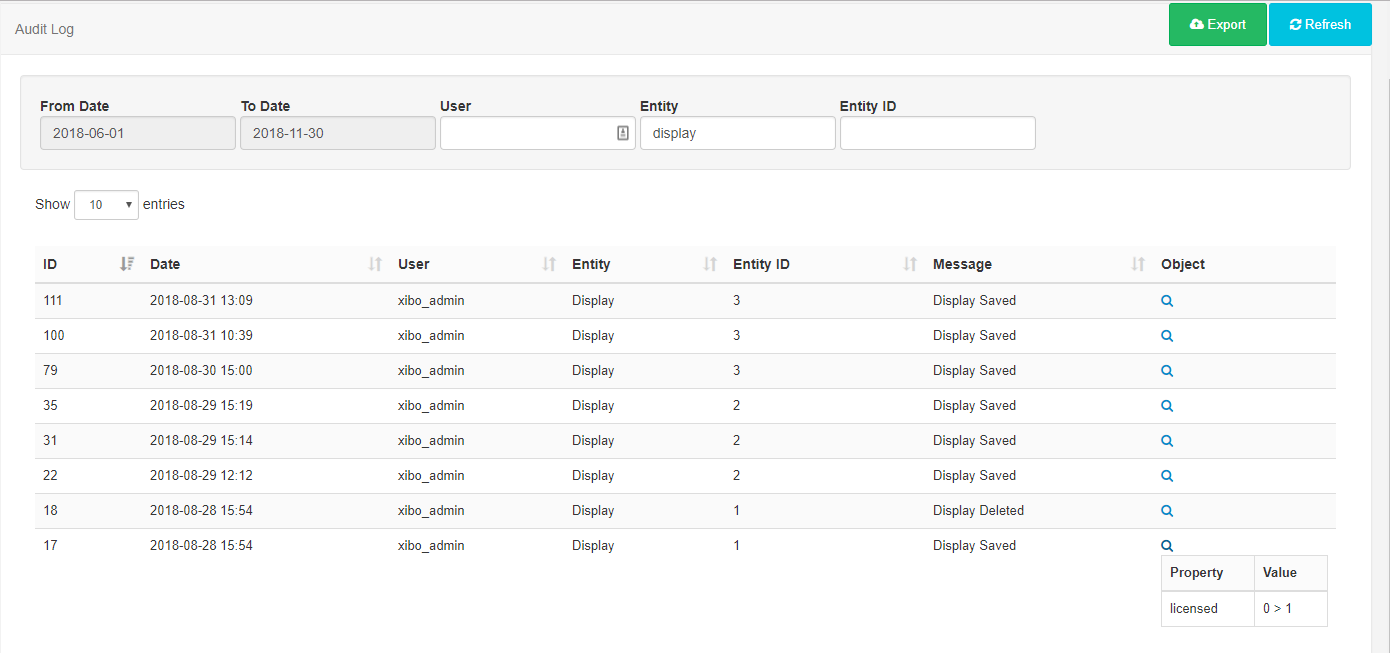

You can confirm when your Display was connected to your CMS using the Audit Trail option in your CMS.
If you first confirm the Display ID number for the Display, which can be found in the Displays option in your CMS, you can enter that Display ID number into the Identity Number field on the Audit Trail page. You can also enter Display into the Entity field to narrow down the results to just Display information.
You will need to look for Entries named Display Saved in the Message column. If you click on the Magnifying Glass icon in the Object column, it will confirm the specific type of entry for that Display. If you see an object Entry that states “licensed 0 > 1”, this is an entry showing that at that time, the Display was Authorised in your CMS.
Below is a screenshot from my Audit Trail, showing the type of entry I’m referring to:
