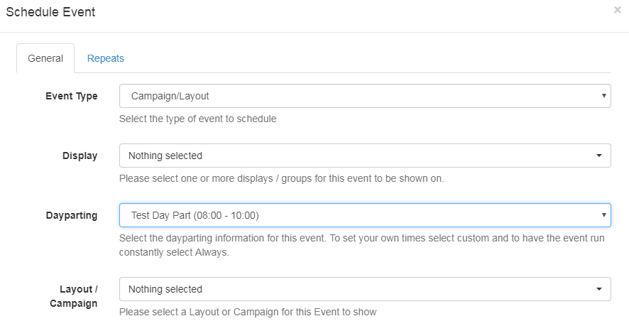

I have created 2 day part named as “Morning” and “Test DayPart (8:00 -10:00)”. When i use “Test DayPart (8:00 -10:00)” day part in the schedule, Start Time text box not visible to me. However it is visible for “Morning” day part. Below are the screenshot of the schedule event screen.
I’ve confirmed this issue on 1.8.5 CMS, basically the first daypart you create will get incorrect daypartId, every daypart created after that will be fine - as a work around I’d suggest removing the first daypart you created and re-create it, it will then get a new daypartId that should not interfere anymore.
The GitHub issue about it, is here - https://github.com/xibosignage/xibo/issues/1406
