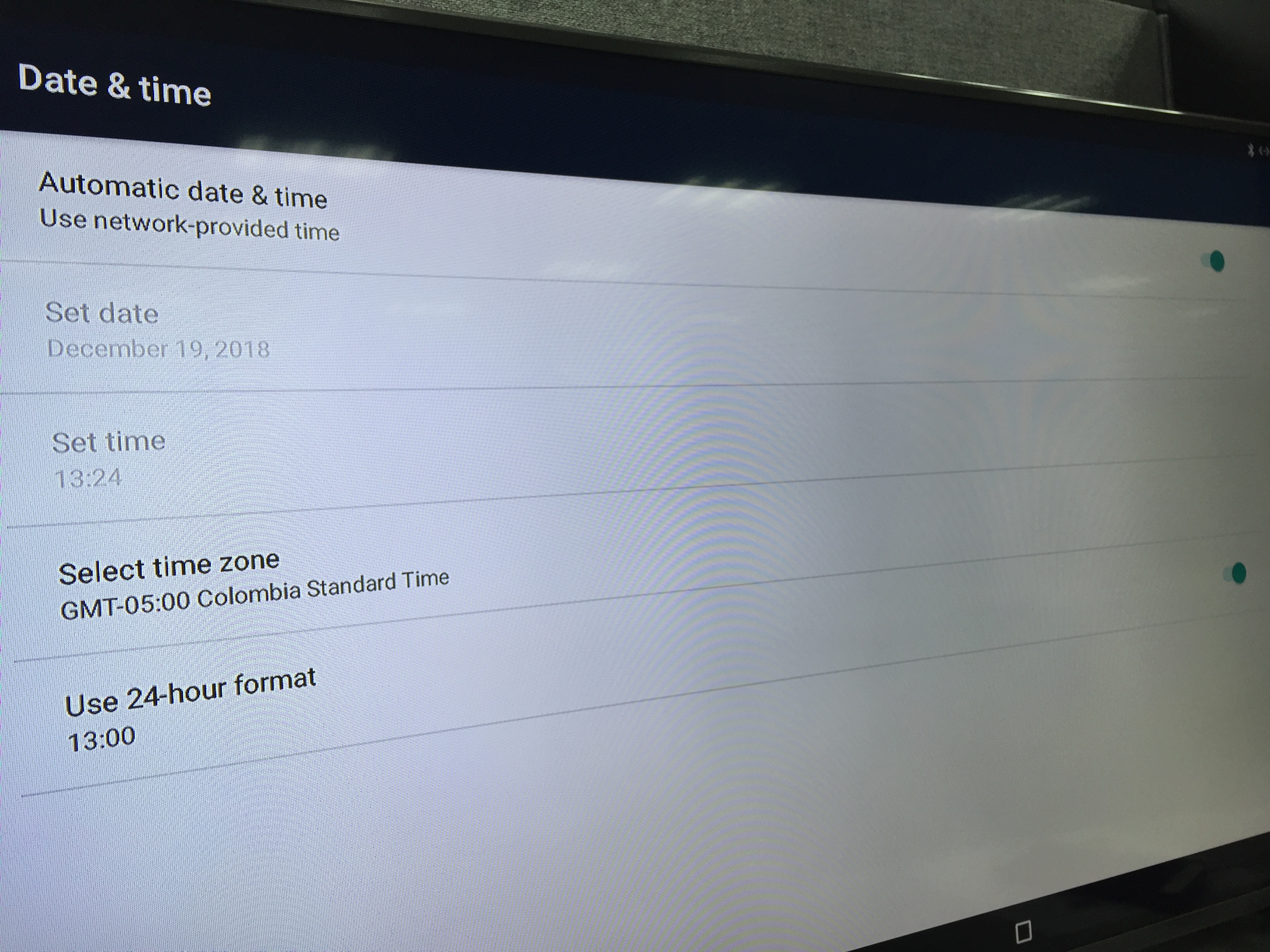

My DsDevices lost the date&time configuration every one-two days and i dont know why. When the date&time configuration get lost my android licences not work (for date&time reasons) and i have to connect a usb mouse+keyboard to fix the problem in the android system.
How can i auto update the date&time? I have checked this option(view attached image)…but it get lost with the days

Select the Preference option and choose Date and Time from the menu. Make sure Use network-provided is set to Open and make sure the time zone is set correctly. If this does not resolve the issue, I would recommend setting the time and date using the manual settings to see if the issue is resolved.

My configuration says “use network-provided” on … I tried “manual settings” too but when i turn off the DSDevice the configuration get lost and back to December 2014.
