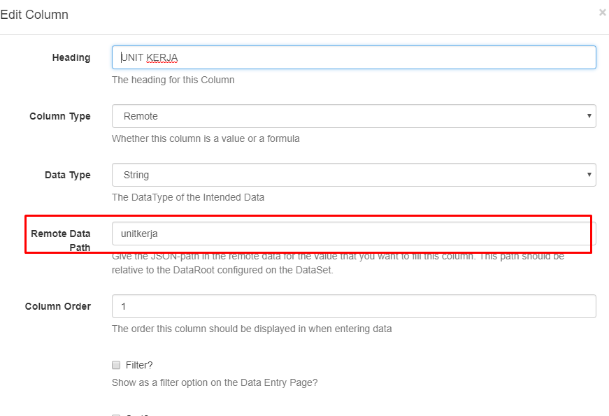

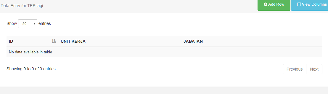

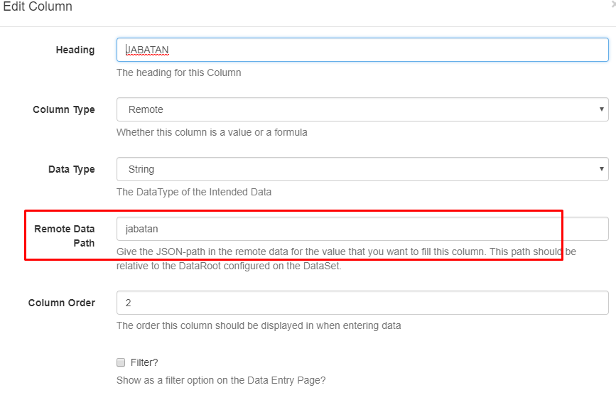

Dataset remote not work for me
please help me… where is the problem…

In your second post the Processed appears to be correct?
As such the question is if the fetch remote dataSets task did run or not.
Could you confirm for me the CMS version you have and if it’s custom or docker installation?
Look at the Tasks page and see if the task did run.
If you look at the Datasets page you should see a recent date in the last sync column in the row with your remote dataSet, if there isn’t one then it would imply that the task did not run.
If you’re using custom instillation on a web server, then please ensure that XTR is configured and running - https://xibo.org.uk/manual/en/install_xtr.html
In docker XTR is pre-configured and should be running without any manual changes required.
I use cms version 1.8.4
