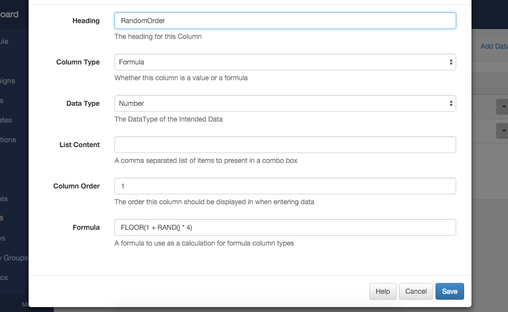

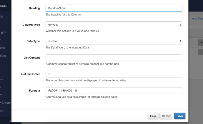

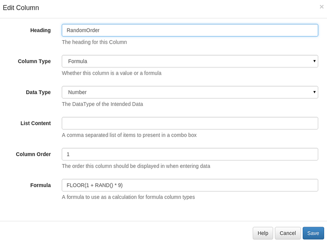

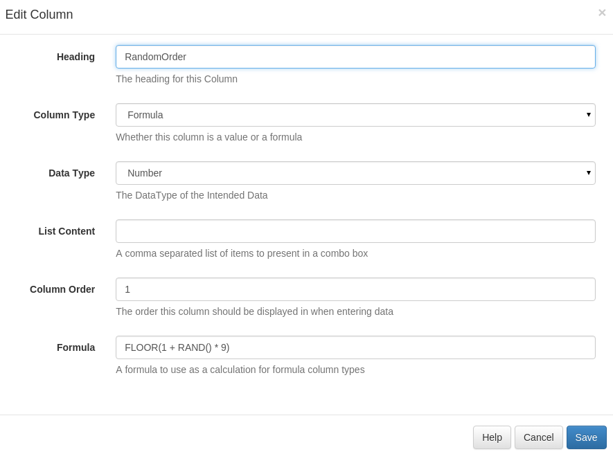

I think you want to create a formula column like this:

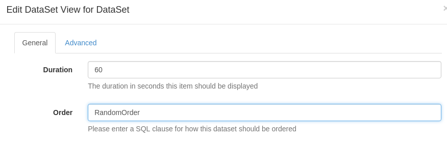

And then order it like this:

Two columns - col1 = the text you want to randomise, col2 = the formula column as shown in the screenshot
Got it to work with what you posted above Dan. Only issue I am running into now is that on " dataset " it displays all items randomly during the time, not one item for the specified time.

You could set the upper and lower row limits to 1 and 1 so that only 1 item is shown
Got it to display 1 item per page. Set time to 1 minute, so updates very frequently. Works great.

using equation that you specified Dan " ( FLOOR(1 + RAND() * 9)"
changed the 9 to a 4, to see if it helps. Anything else can do to make it totally random and choose a different one (not previously choosen for a while ) every time ?
