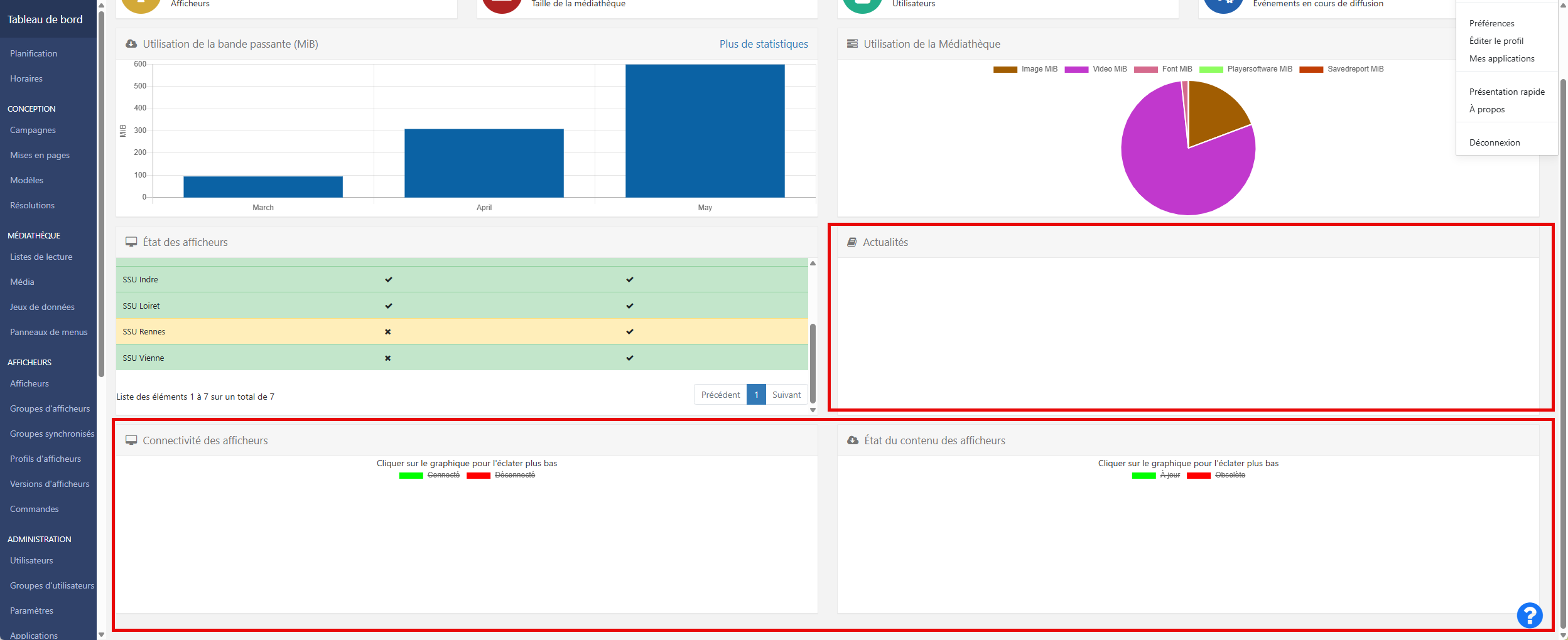

Issue :
Since some day, on dashboard i’ve issue with Screen connectivity and state of screen.
Do you know how can i fix it?
Thanks for your help

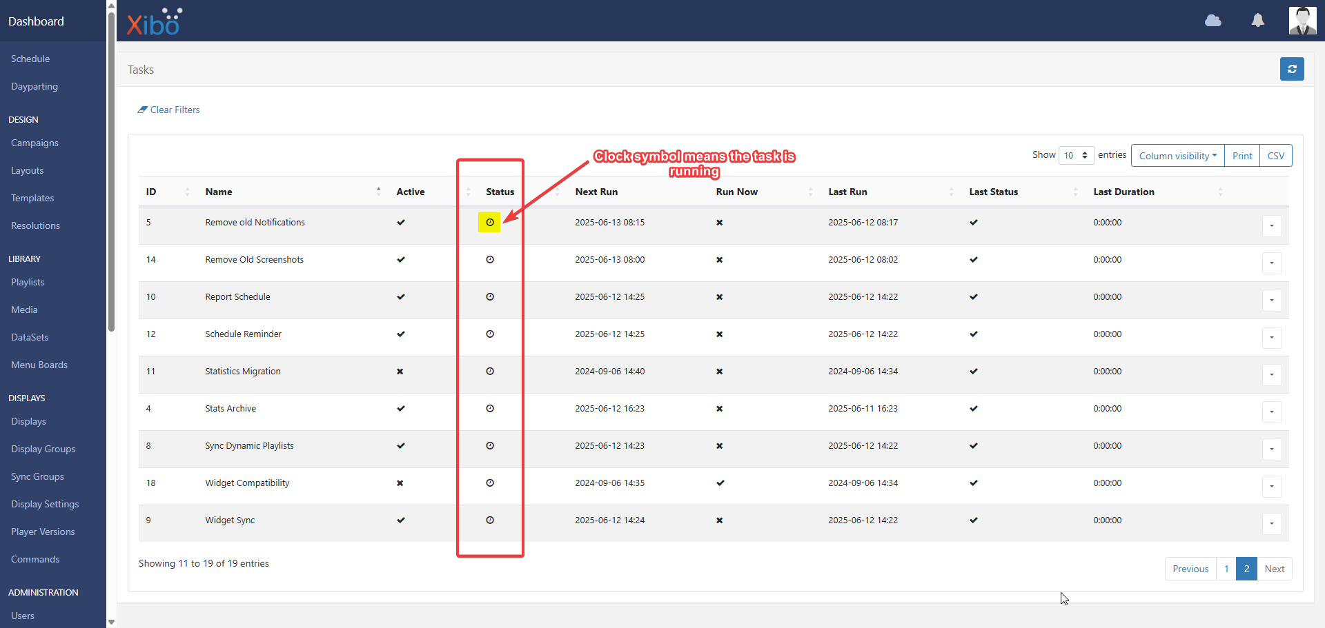

My name is Jerry from the Support Team. Sorry to hear about the issue regarding your CMS dashboard section not showing data. Could you please check if all the tasks in your CMS are all running? To do so, In your CMS go to > Task. Look under the status column if there are any tasks that are not running; if they are running, you should see a clock symbol. If you see a bug symbol, you may click the row menu to run that task.
Here is an example of the task section where you can see that all task are running as being indicated by the clock symbol under the ‘Status’ column.

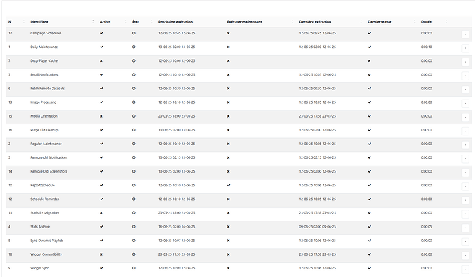

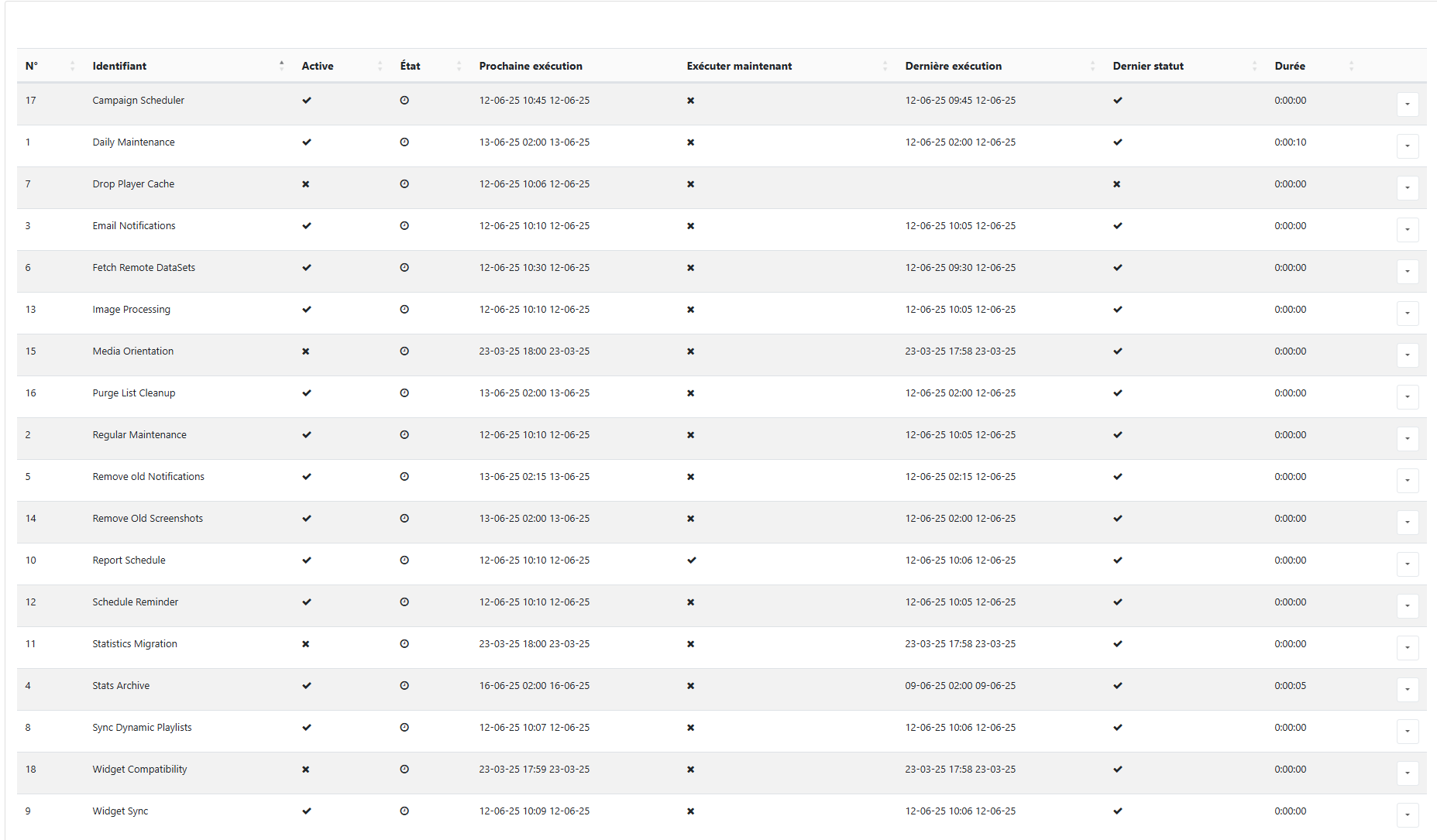

Hi Jerry
Thanks for your answer.
You can find screen.
Hi luhut,
Thank you for your reponse!
I don’t see anything wrong on the task in your CMS based on the screenshot you’ve provided. Could you please run the ‘Report Fault’ wizard in your CMS maybe we can capture what is causing the issue in that log? To do so, go to your CMS > Report Fault. Follow the prompts on the Report Fault wizard and try to reload your dashboard. It will generate a troubleshoot.zip, please upload it here and provide me the download link.

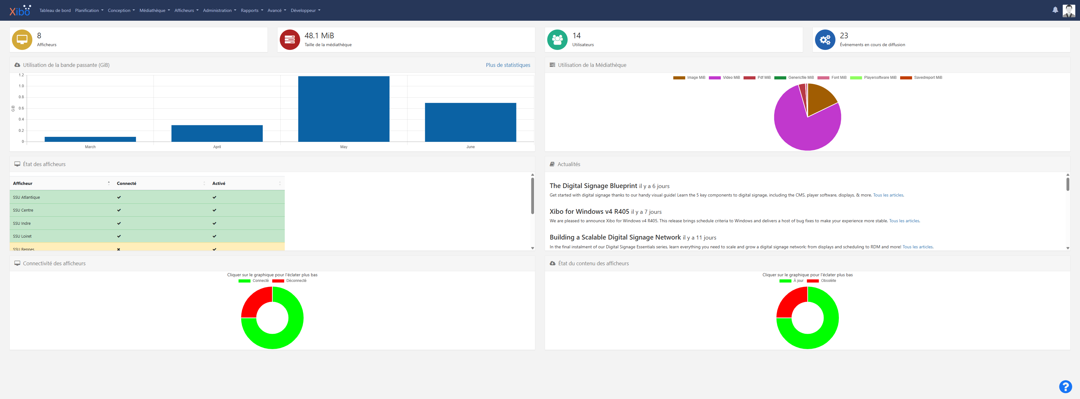

I’ve clear all setting in networks section and issue is endded.

Could you please confirm that clearing or deleting the information in all the fields in CMS > Settings > Network tab and then saving it fixed the dashboard issue for you?
Hope to hear from you soon.
Kind regards,
Hi @JerryW
Yes, all is ok now. Thanks for your support, we continue to deploye :slight_smile:
