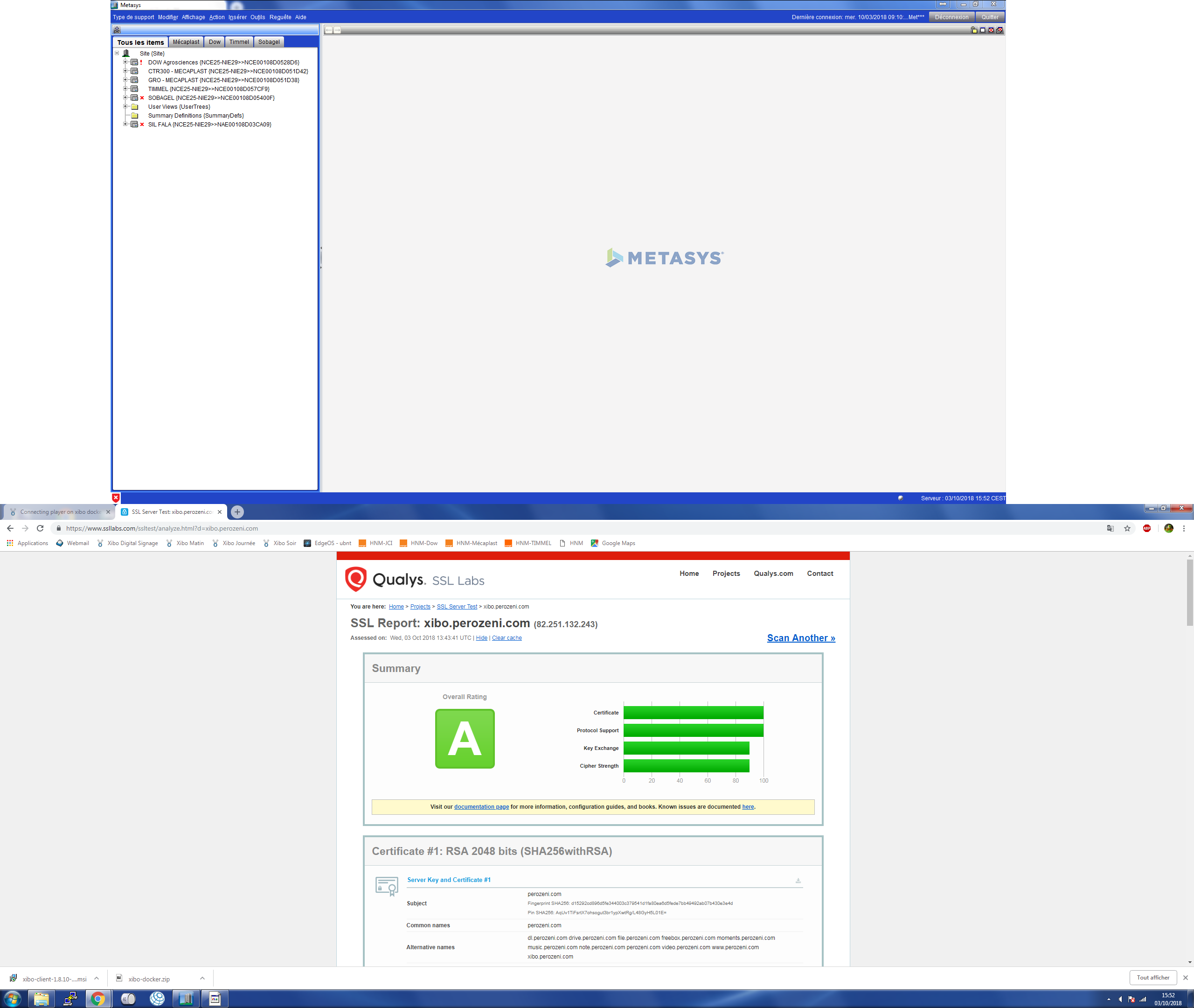

Are you using SSL? If so, please use Quallys SSL labs to check your SSL configuration, especially with respect to any certificate chain issues.

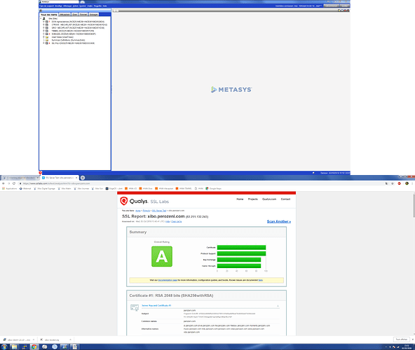

Thank you Alex for the quick answer.
I don’t know how to interpret the results but it seems good. The note is a A and everything is green
That all looks OK.
