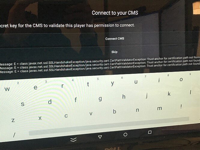

Hi, i have the same configuration in My Httpd.
i try to test with a DSCS9 i have this error :slight_smile:Method XmdsBase. Message: E class javax.net.ssl.SSLHandshakeExecption/java.security.cert.CertPathValidatorExecption : Trust anchor for certification path not found
if you have any idea. i have some DSC9 to configure
thanks
I think we might be jumping around topics a bit here :slight_smile:
That error means you have a problem with your SSL certificate and isn’t anything to do with send_file. If you’re using a self signed certification you can open the CMS in your Android browser first and trust that cert.
Hi Dan, i am able to connect to the CMS froms the android browser but when i try to connect CMS in Xibo apps i have error message :
Can you test the HTTPS version of your CMS URL at: https://whatsmychaincert.com/ and that should tell you what the problem is.
Basically the error message is saying that the HTTP Client can’t validate the SSL certificate - this can happen if its self-signed for example, or if you’re using a certificate that isn’t in the cert store on the device.
SSL isn’t really my area of expertise i’m afraid, so if the above doesn’t point you in the right direction you may need to contact the Help Desk (support is available for both Android and Tizen on there).
Hello, thanks for your Help.
finally there is missing an intermediate license file on the server which is not necessary to connect it via the Web Browser. android need to download this file to truster CMS. then reconfuguring the SSL again to make it work.
thanks
Fantastic - i’m pleased you figured it out!
