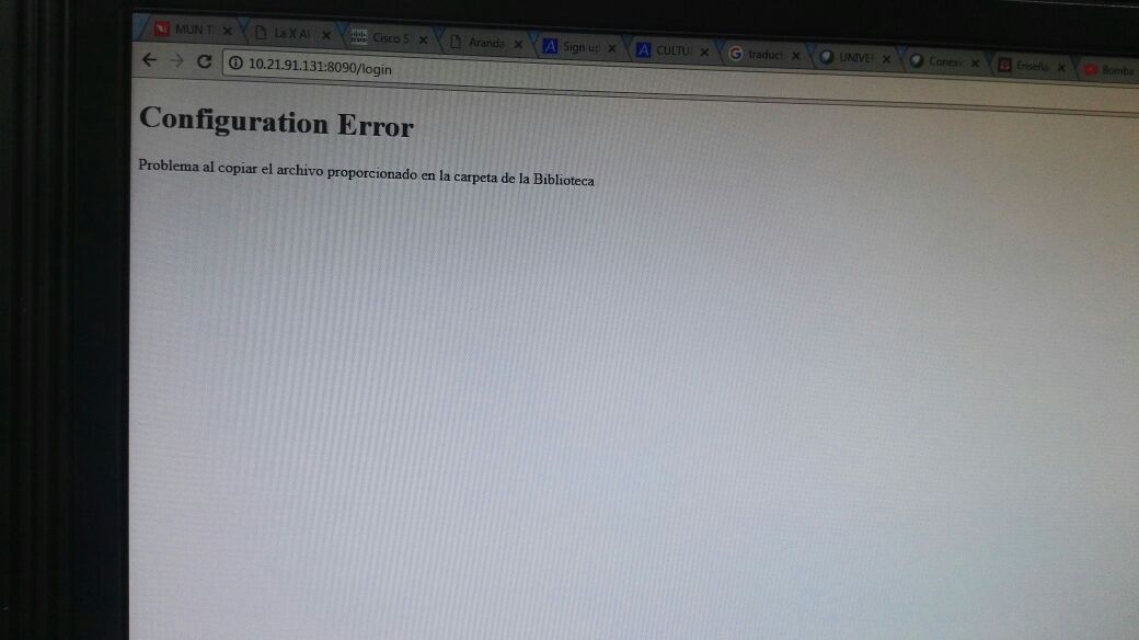

I am having a problem with the CMS 1.8.7.
When I access to Login. It shows:
I can’t see logs, I can’t login to xibo_admin.

It looks like a filesystem permission issue to me. Perhaps something changed the filesystem permissions on your shared directory?

The error is telling you that it can’t write to the library directory so you do have a file system permission issue which you need to resolve. It has nothing to do with the docker-compose file

Removing the shared library, I could log in xibo admin and reconfigure the server, fortunerly the server doesn’t have too many screens. I tried to restore from backup, but it showed the same error, I had to import manually the files in library.
