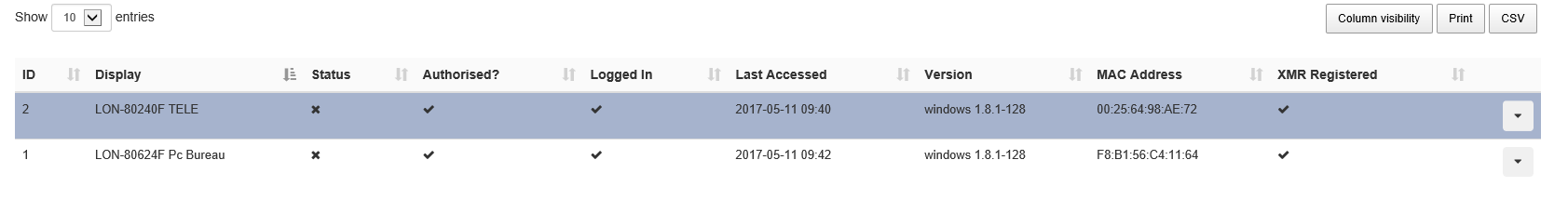

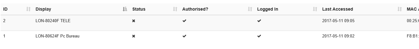

I Use RedHat 7.3, Xibo CMS 1.8.1 is running on this server. when i can’t send command to the Player, I can’t recen Screen Shot and Thumbnail from Player.
In the Player : XMR Status : connected to tcp://10.xx.xx.xx:9505 (10.xx.xx.xx is mys CMS IP )

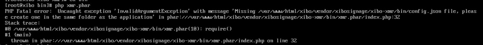

I try to XMR.PHAR /var/www/html/xibo/vendor/xibosignage/xibo-xm
r/bin byt i receive this message
Uploading…
conf

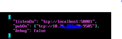

conig.json in /var/www/html/xibo/vendor ins configured like this
“listenOn”: “tcp://localhost:50001”,
“pubOn”: [“tcp://mycmsIP:9505”],
“debug”: false

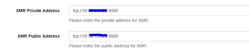

Do you have the same public/private addresses in CMS Settings?

The window shows “Missing config.json”. The config.json is misplaced in the wrong directory, I think

That private address in CMS settings does not seem to be the same as in the xmr config…

Hi Peter!
this is my config.json in xibo/vendor/bin
10.xx.xx.xx is my CMS adress. it’s the same adress that i put in CMS setting.

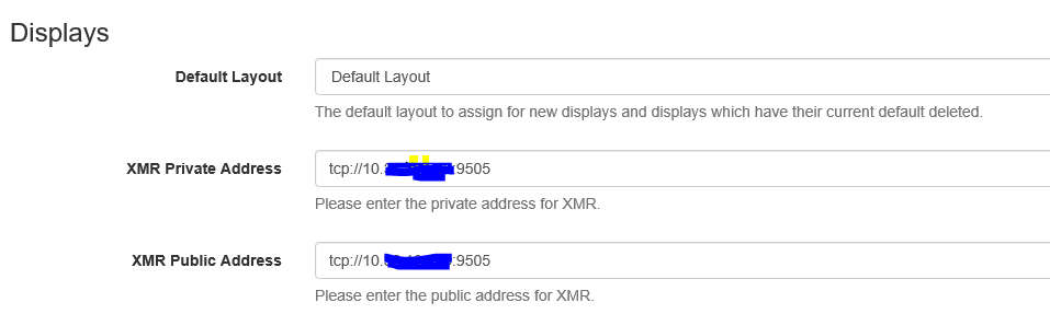

CMS
XMR Private Address: tcp://localhost:50001
XMR Public Address: tcp://10.xxx.xxx.xxx:9505
Thanks i change adress in CMS but no think change i c’ant send command, screenshot… to Player

You must also solve the problem with Missing config.json, see message in command window (PHP fatal error)
config.json must be in vendor/bin
bur when i un xmr.phar in …xibo/vendor/xibosignage/xibo-xmr/bin/
error returned is
anather conig is nessacery in …xibo/vendor/xibosignage/xibo-xmr/bin/ ?

The error message tells you exactly where the config.json file needs to be Put it there.
