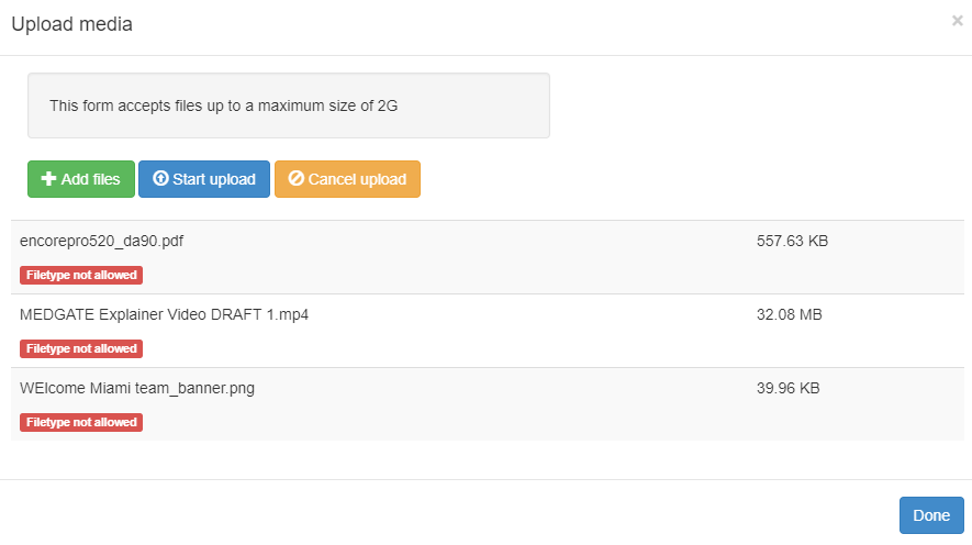

We just tried to upload new medias/files for our layouts and all files uploaded suddenly displays an error saying “Filetype not allowed”
Please see the screenshot for reference:

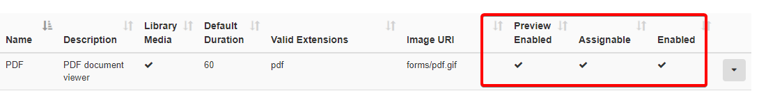

Could navigate to the Modules page and check that the valid extensions there are correctly set for the corresponding modules ie PDF - .pdf, Image - .png Video - .mp4.
If not adjust that, if yes, try to run verify all on Modules page.

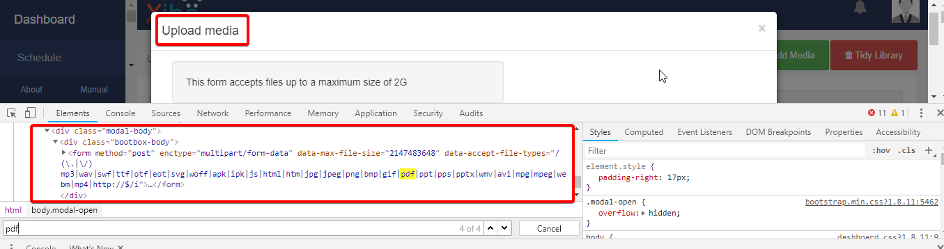

You could also right-click on the upload form → Insepct
then you should see the list of allowed extensions on that form, something like:
That’s generated from valid extensions set on the modules on Modules page.

I already verified the extensions and all the basic extensions are ENABLED.
I already tried to VERIFY ALL modules in the Modules page, but still no luck.

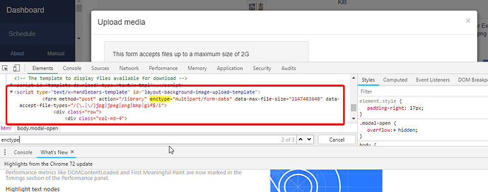

And here are the filetypes under INSPECT:
I’m not sure why other file types are not showing here, maybe I’m on a different page.

The upload form that you inspected seems to be the layout background upload form, which rightfully so accepts only images.
I’d expect the upload form on Library media page to have more extensions though, could you please confirm that for me?
I suspect that, it’s just the case that you didn’t look at the part of the code you wanted to in this case :slight_smile:

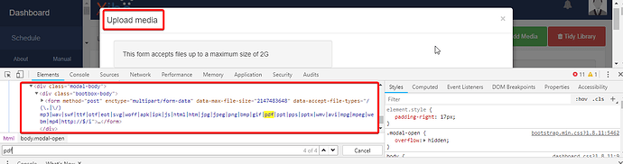

Hi @Peter,
I think this is the correct one,
Sorry for the mistake,

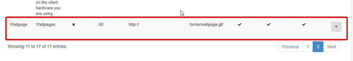

hmm in what module do you have http:// as valid extension?
At a guess that’s what breaks it for you, and of course http is not a valid file extension.
I’m not sure how else it could end up there if you don’t have it listed somewhere in valid extensions :thinking:
Hi @Peter,
It’s the WEBPAGE module,
Here it is:
I’ll try to disable it and will let you know the results,
