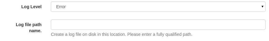

The penny dropped - is this log file created because you have put something in this setting:
If so, then it makes perfect sense that it grow in size indefinitely. The player routinely creates and sends log files to the CMS - this is the mechanism I thought you were using - it makes sense that you aren’t!

Re the logs, I have indeed populated that field. Would it be better not to? I guess it’d mean the logs would only exist on the CMS and never permanently on the client. I hadn’t realised this- I thought I was just specifying the temporary location of the log file prior to it uploading to the CMS. It’ll explain some of the disk space issues I’ve been having, that’s for sure!
