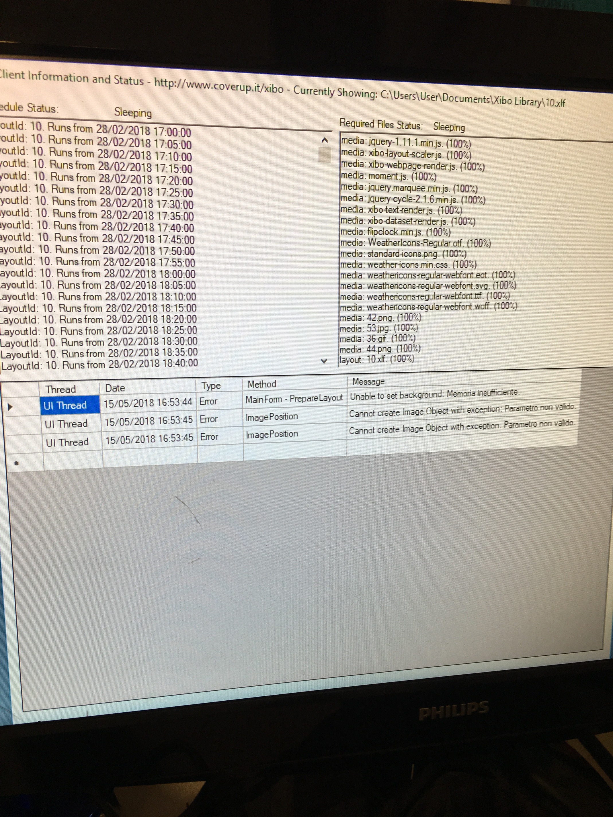

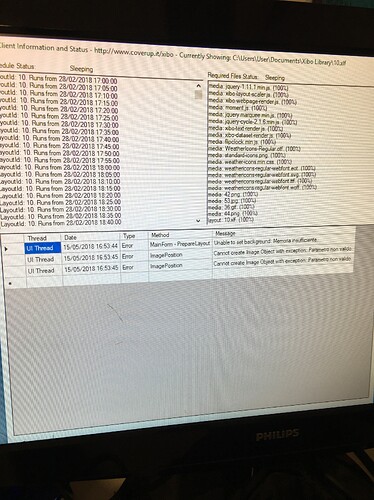

One of the monitor is costantly on the “Display is downloading new files” status, I cannot schedule any event on the CMS, when I try I got this log on the monitor
“2018-04-13 11:18:29 Client [UI Thread] MainForm - ChangeToNextLayout Layout Change to C:\Users\User\Documents\Xibo Library\10.xlf failed. Exception raised was: Unable to set any region media nodes.”

You seem to have quite a lot of events scheduled with that layout, there is an error about insufficient memory reported there as well.
It could be a good test to clear the schedule and then create one event with that layout to see if your device will be able to show it.

I just cleared the schedule of the last month and now the layout is running fine, the only remaining problem is that the display is still on “Display is downloading new files” state.

You could have a look at the Media Inventory on that display to see what files are reported as incomplete.
As for the layout, you have a layout background .png image, which will most likely not work well on Windows players - you should have that in .jpg format.
