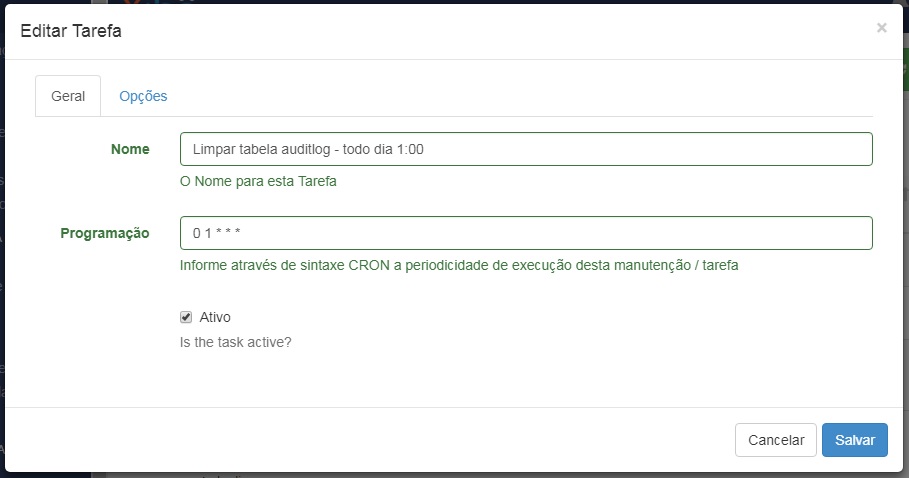

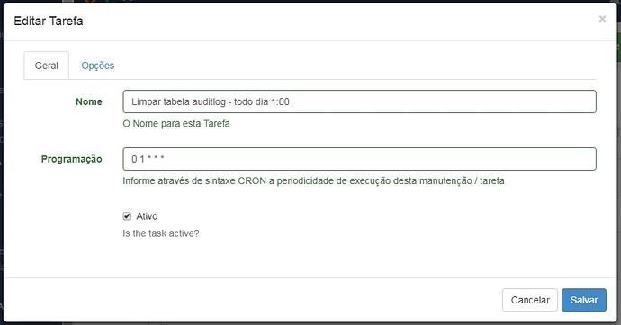

Your task looks fine. It will run at 1am each day, and archive a little each time. If you have a huge backlog, it will take many weeks to get up to date. It will not delete everything in the table too, only older records will be removed.

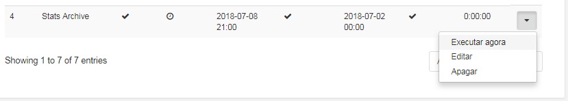

The maintenance of the “stats” table is scheduled for 08/07/2018.
I clicked “RUN NOW” and it did not work.
As you can see the last execution was on 07/02/2018, and after I clicked “RUN NOW” several times the table “stats” had no change in its size or the date of last execution.

Run now will simply mean that the task is run next time XTR executes.
By default, 2 months of stats data is kept by the task, so it’s not going to do anything if you keep running it over and over again.
We know the code works. We use it every day. When the stats in your database are older than the limits the task works to, they will be archived in to the library as expected.
