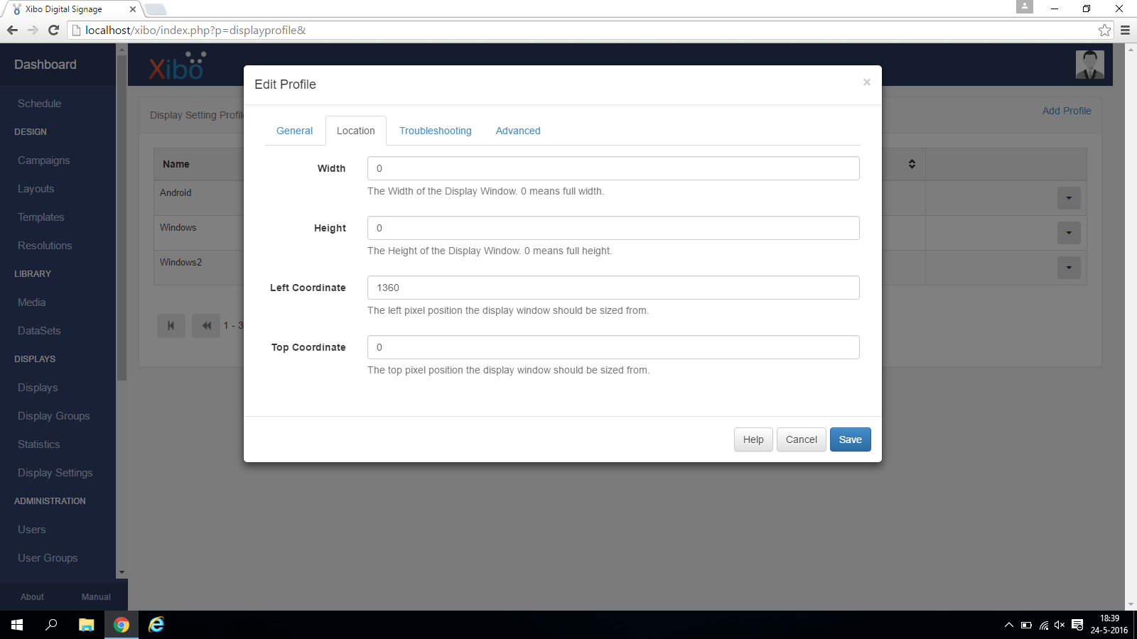

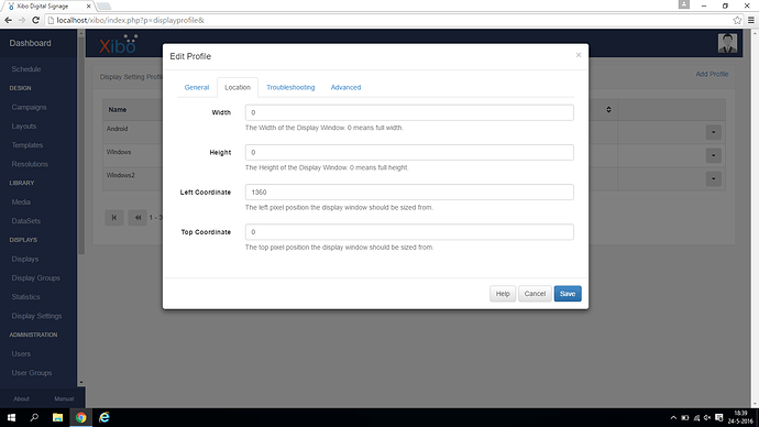

And the positioning doesnt change. the width of the screen is 1360pixxels, so i putt that in the Leftcoordinate.
Am i doing something wrong?

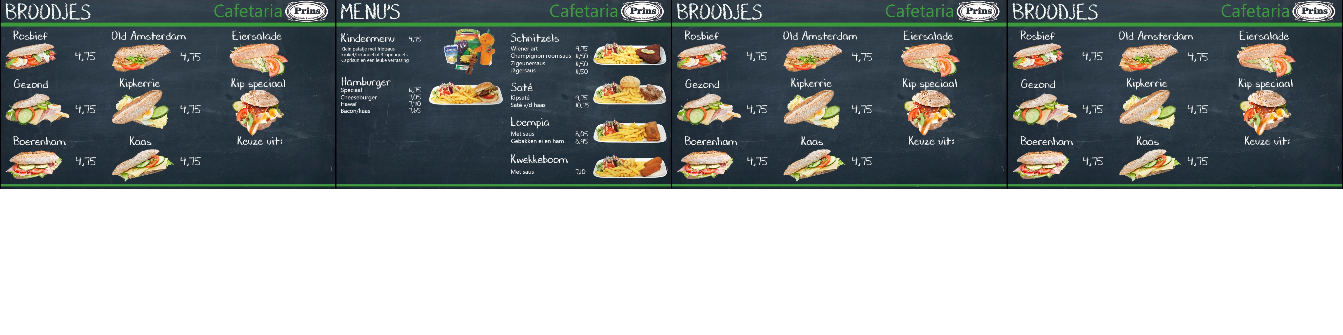

I got everything workin!
I have installed 4 players, and can play different templates on all 4 players.

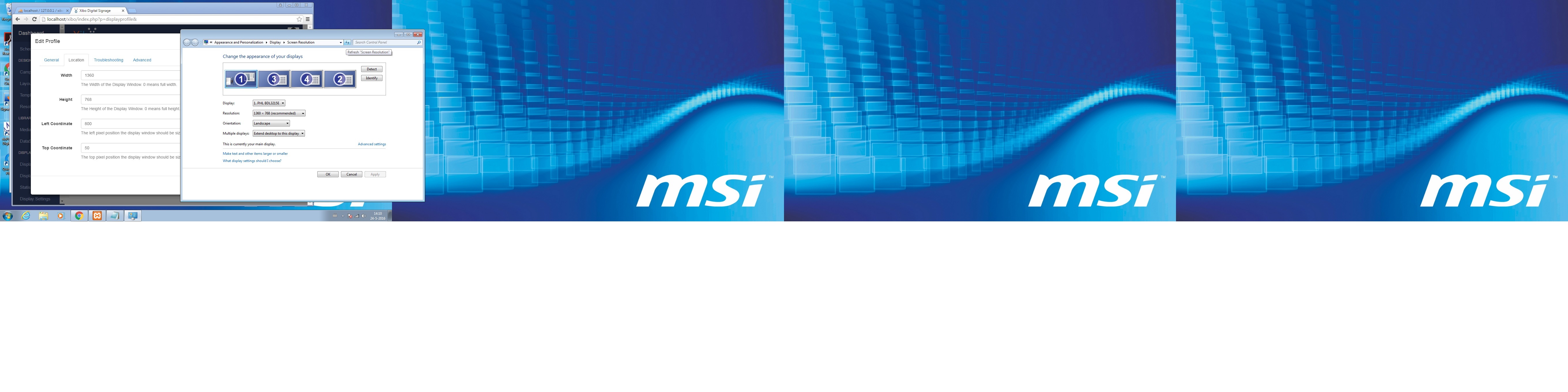

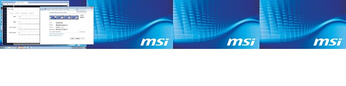

The only problem i have now, is setting up the 4 players on the 4 seperate displays.
I have tried somethings as you can see on the picture. But i cant get a player on the other displays. Al players are loaded in the Main screen.
Hope someone has the answer for me:)

Hi, what did you do to displace the player?? i tried with the coordinates in the profile but still open in the main display!
In Display Settings under Location define an actual width and height instead of leaving the number 0 in there.
yes! thank you! that was the solution.
