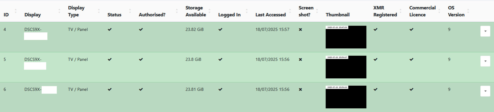

Hello everybody,
I run 3 DSCS9X with my Xibo CMS, but every time I try to request a screenshot, I’m always getting a black screen.
Can you guys help me ?
Best regards!

I also set the Display Profile to take a screenshot every 5 minutes, but it doesn’t seem to work. I have to request a screenshot manually to make it happen.
Another thing I don’t understand: why does the ‘Screen Shot?’ column display a cross?
Best regards!

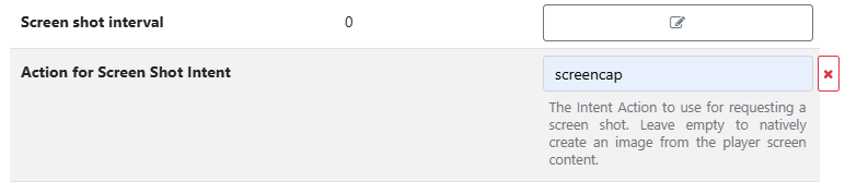

I suspect this may be because you have videos running on the Xibo player at the time you request a screenshot. Schweminska is absolutely right to share that post with you. That post explains that videos are hardware accelerated, which is why you see a black screen when you request a screenshot of a video.
Within that post it also explains that you can also try using the screencap screenshot intent. Have you tried that on your DSCS9Xs?
In case you haven’t please follow these steps:
  • Log into your CMS and go to the Displays page.
  • Click the button at the end of the entry for your display and choose Edit from the menu that appears.
  • When the Edit Display window opens, go to the Settings tab. You will see a series of settings that have an override box. Locate the option named Action for Screen Shot Intent and set the override to screencap:
  • Save the change and wait for your display to connect to your CMS and collect that change.
After this, you may find that the screenshot will instead return showing the video instead of a black screen. Please note that there may also be a slight delay with the screenshots being returned, this is due to the extra steps required for the screencap action.
Can you try this and let me know if it solves your issue?
Could you follow the steps above and try setting the override for screenshot interval to 5 minutes (you can see the option in my screenshot earlier in my post)? You will need to check the time stamp in the top corner of your screenshot to see if it has updated. If you then allow 5-10 minutes more, refresh the page (this is very important), then check the screenshot thumbnail again to see if the time stamp is updated. If you don’t refresh the page you will not see new screenshots come through.
There are two statuses for the screenshot column; tick or cross. The tick means you have requested a screenshot that has not yet been returned. That will switch to a cross when the screenshot has been returned. I can appreciate that may not be immediately obvious.

I followed all the steps in your procedure, and everything seems to be working perfectly.
Indeed, the screenshot module does feel a bit clunky and slow, but it gets the job done for verifying that my content is running correctly on the players.
Also, thanks for clarifying the purpose of the screenshot column. Much appreciated!
