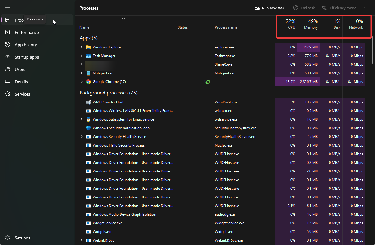

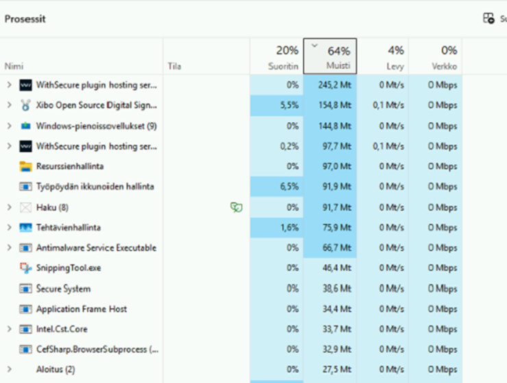

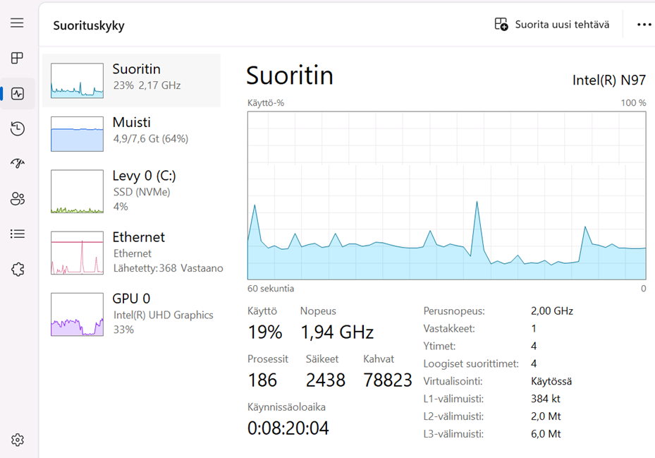

  • Screenshot of your Task Manager in your PC showing the CPU, Memory, Disk, and Network usage while the issue is happening?
Here is my Task Manager Processes window as an example.

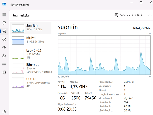

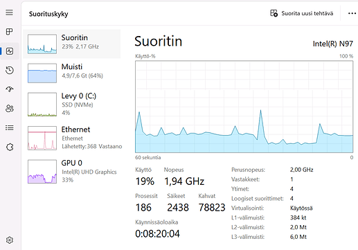

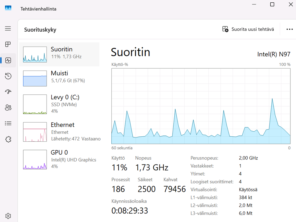

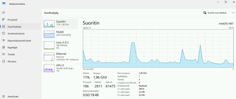

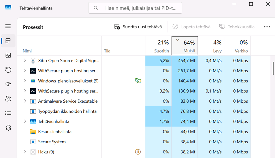

The memory usage seems to increase over time and I think Xibo could have a memory leak.
When Xibo is started, the memory usage is approximately 150 MB.

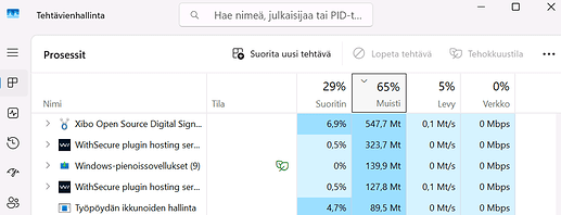

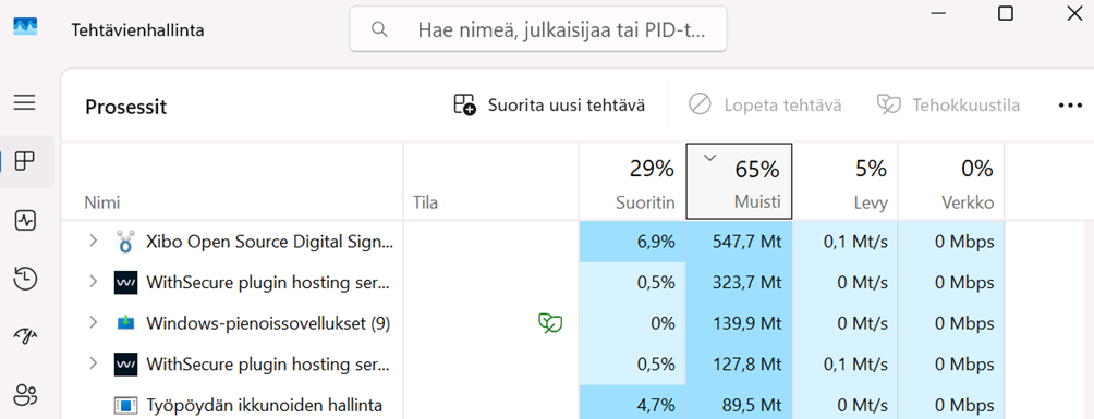

Xibo Windows Player After 8 Hours
Memory usage has increased to 454 MB.
Nine minutes after I took the previous screenshot, I noticed that the video had stopped playing, and the screen was displaying only an image. (I am displaying a video and an image on the Xibo Windows player) The memory usage had increased to 547 MB, and I received the following error:
