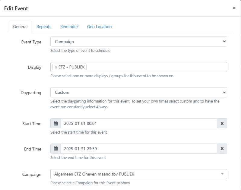

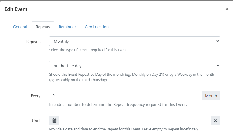

I’m trying to set up a bi-monthly reapintg schedule for a campaign, but not very succesful at it.
My settings:
and

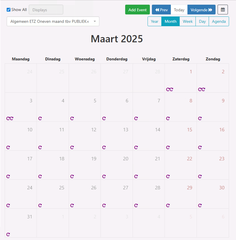

The result is that the campaign is scheduled for every day of every month. In months that follow a month with fewer than 31 days, it is scheduled twice on the first day of that month.
Does anyone have a tip how to accomplish this, or is this a bug?
Hi @sp_etz , please can you elaborate on what you are trying to achieve? In the event that you have created there, you are asking the system to add the Campaign to the schedule for 31 days on every 1st day of the month which, from what you describe, is exactly what it is doing.

I believe that leaving the ‘on the 1st day’ box blank would achieve what you require. Please can you try this and let me know?
Hi Frazer, thank you for your suggestion. Leaving “on the 1st day“ empty does not have the desired effect:
The schedule is effective every month and overlapping when previous months had less than 31 days.
Any other things I can try?
I should have added that the “on the 1st day“ is automatically added when left empty.
