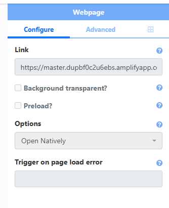

I have tested your URL Listnr Dashboard in a layout, using a standard webpage widget. These are the settings I used:

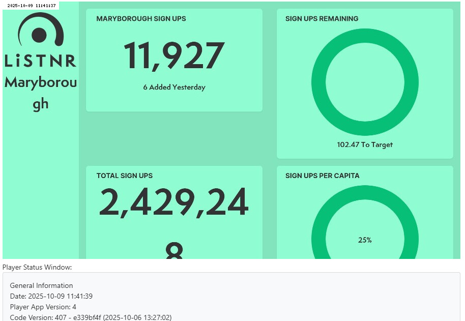

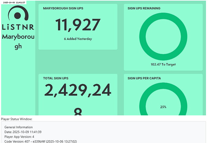

When I scheduled that layout to my Android player (R407, connected to a 4.3.0 CMS), I was able to view the webpage on my Android player. Here is a screenshot from my player showing the webpage:
What version is the Webview on your Android device? My device is using Webview version 99.0.4844.48. If you Webview version is older than this. it coud explain why it is not rendering on your Android device.
